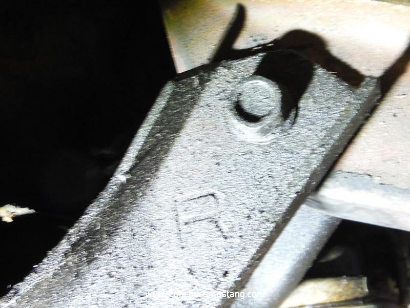

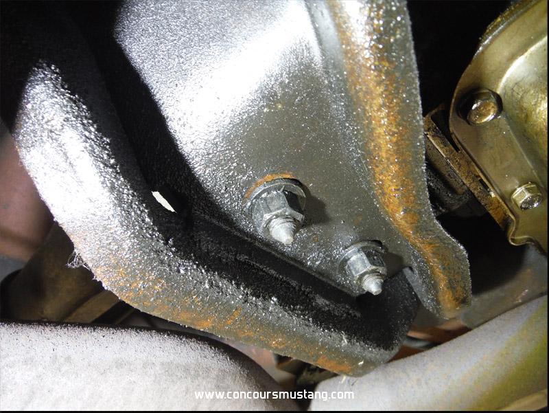

There are a bunch of them that look pretty similar to one another
There is a close up picture of the same transmission mount shown in the unrestored picture area of the site in the one marked
67 San Jose 390 GTA Fastback - Unrestored Picture Thread
Picture is labeled U-10 on the third page
Numbers you found are the date code and based on your signature it was made a couple of months or so  prior to your car's completion date
A few additional pictures from that unrestored late San Jose 390 GTA. Compare these details with the one you have

From what I recall the 390 c6 cross member has more reinforcement. The blue one picture has the reinforcement that runs across 3/4?s of the back side which would be for a small block. The 390 version has the reinforcement all the way across from end to end. Looking at the pictures Jeff posted you can see that where the large R is stamped there is reinforcement metal above the R stamping basically creating a channel.
