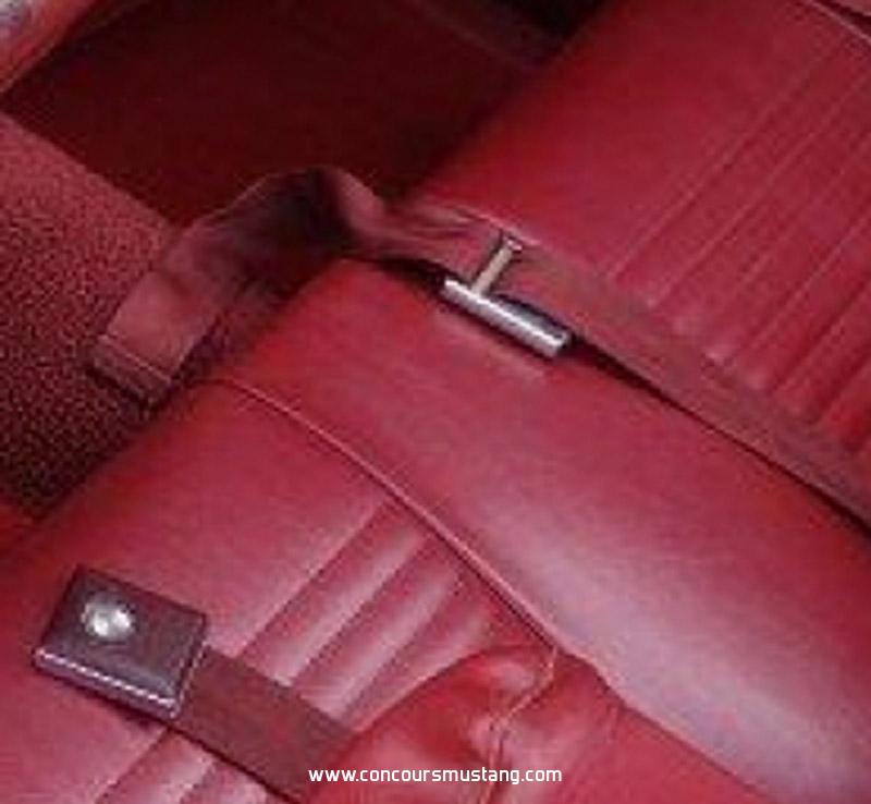

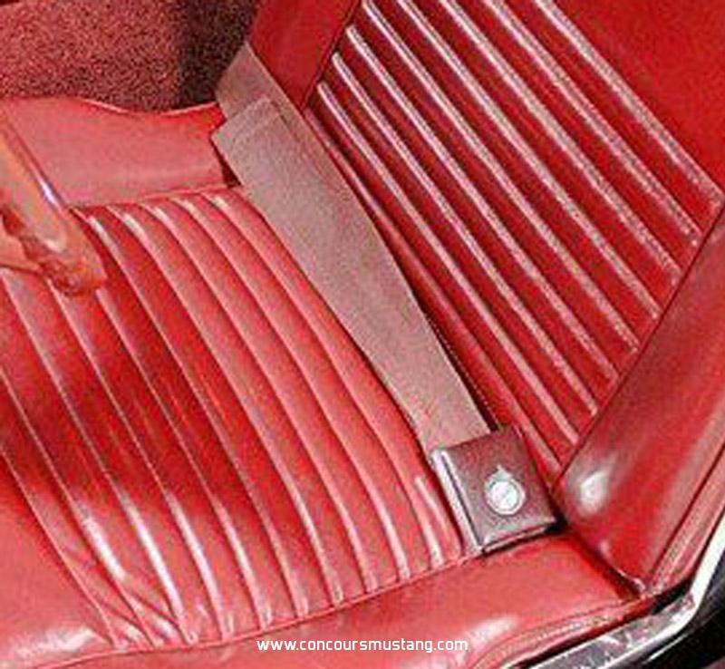

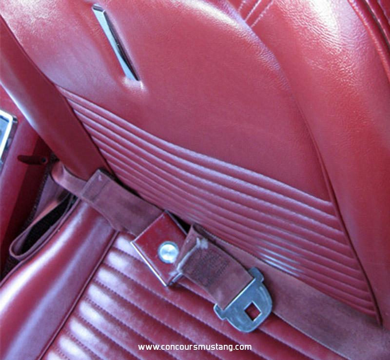

Think not since since that reference relates to painted items but likely the supplier was asked to try and match one of those (likely a sample was provided) and they got it as close as possible and it was approved.
Could post other examples but of course the look would vary due to lighting, age and condition of belts as well as other things but maybe by comparing them to things around them that might be helpful so here goes

Thank you for the photos Jeff. In your opinion is the carpet supposed to match the seat color? A company sent a photo of the color options. Which do you think would be most correct?

Would not want to make a call on which one is closer without being there in person with all the parts. Sorry too much chance IMHO in getting it wrong given all the different looks using the internet, cameras and such

Am not well versed with 1967 Mustangs. That style of seat belt buckle is the deluxe version.
With Dearborn Cougars for 1967, we have noticed that not all colors were available with the base standard seat belts. Some cars received the deluxe seat belts for color match. I think that the dark red or maroon is one of those colors.
Does that hold true for Mustang?

Interesting observation on the deluxe seat belt.
Available as a separate option. If you notice in the one picture I posted above that is a standard interior with deluxe seat belt buckles. Top picture
The front seat belts are not original so I have nothing to compare it to.
You can compare the rears since they would be the same style
