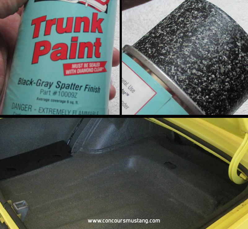

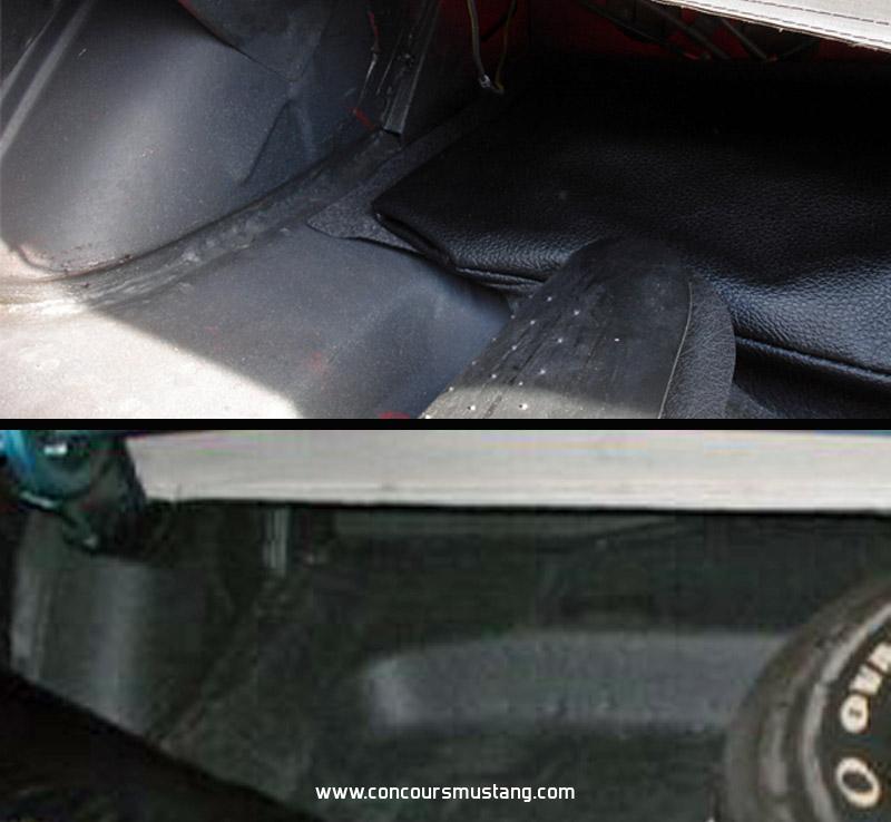

Just for comparison and maybe it will help when choosing a tone of paint color combination
What I used and appears is not longer available from Eastwood. Bottom picture is it applied on my 71. Notice the color is labeled black gray
The finished product compared to an unrestored example Though it was the best I could do out of a rattle can or spray without a custom mix
Two unrestored 73 for comparison. How dark each is may be due to lighting and other things. Top one looks similar to the 71s posted above IMHO Hope some of this is useful

Hello and thank you for your research and the resulting information.
Especially the pictures are very helpful. By the way, it looks very good.
