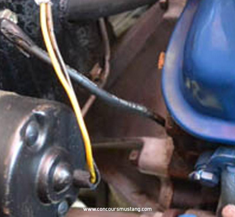

Just looking through some pictures to respond to some other posts and found unrestored original cars with the ground cable at the engine end NOT between the dip stick tube arm and the block. Guess the order could differ depending on assembly plant but not sure in this specific detail that would apply
Will post some pictures in a little while

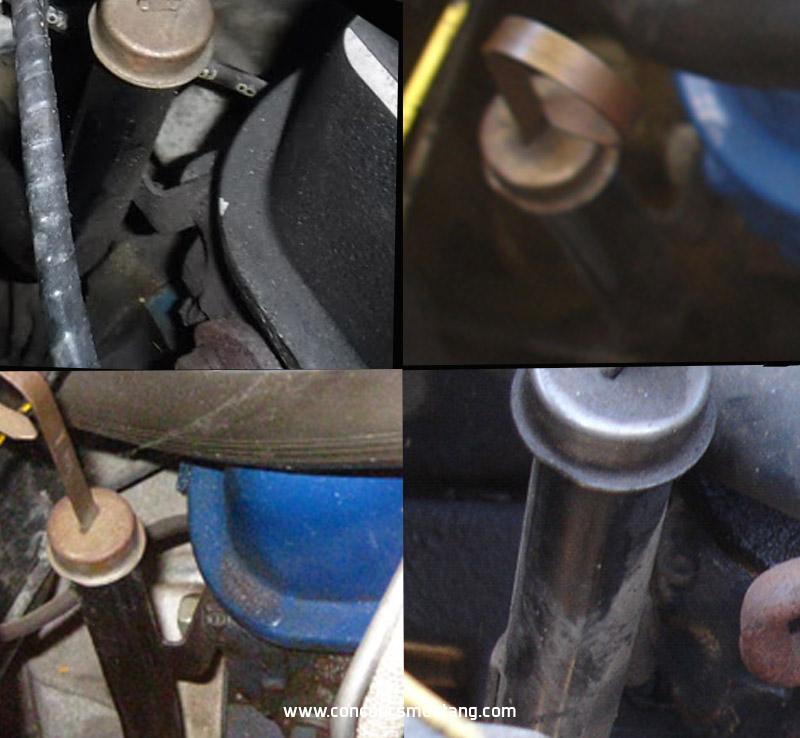

Re: Ground wire, auto transmission oil tube to block attaching order?
« Reply #7 on: June 06, 2022, 07:49:03 PM »
Here are some close-ups difficult area to see unless your really trying to get a picture of the area.
Here happens to be a 66 San Jose manual example where it appears the ground was attached to the other, lower hole at the back of the head
« Last Edit: June 07, 2022, 12:03:29 AM by J_Speegle »
Here happens to be a 66 San Jose example where it appears the ground was attached to the other, lower hole at the back of the head
You can't see much of the washer in question, and the last picture is "missing" the transmission filling tube.

« Reply #9 on: June 07, 2022, 12:04:26 AM »
Added to my picture posting description for the manual transmission example and that its ground is not using that particular hole but another lower one

Ha, this was exactly what Phill B. and I were talking about last night on this subject that there were San Jose examples where the ground cable used the other head hole to the left and wasn't attached where the dipstick tube was. Interesting, guess I better find another bolt ;)
