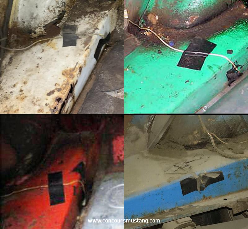

Like topic says, Looking for ideas to properly tape yellow fuel gauge wire to trunk floor. Gaffers black tape, how wide is tape. And pics of taped o e cars    Thanks     Greg    Boss 302 10-21-69 build date, New Jerrsy Car

For the wire to drivers side trunk floor it appears to be three or four inch tape in two locations as shown in the examples below. Easy enough to measure, if you have a car handy) the side of the drop from the top surface of that floor to the lip for the gas tanks and compare that to confirm three or four

Are these examples ALL NJ cars?
Pat
  • Posts: 24919
Pat
Yes, believe so or I would not have posted them to this particular thread and likely all but maybe one from a Boss 302
