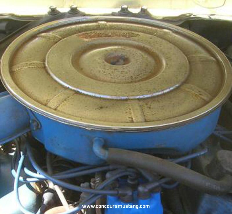

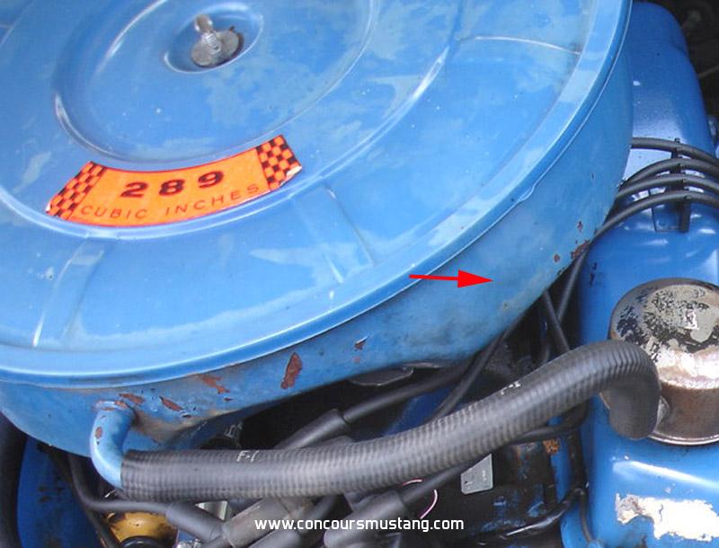

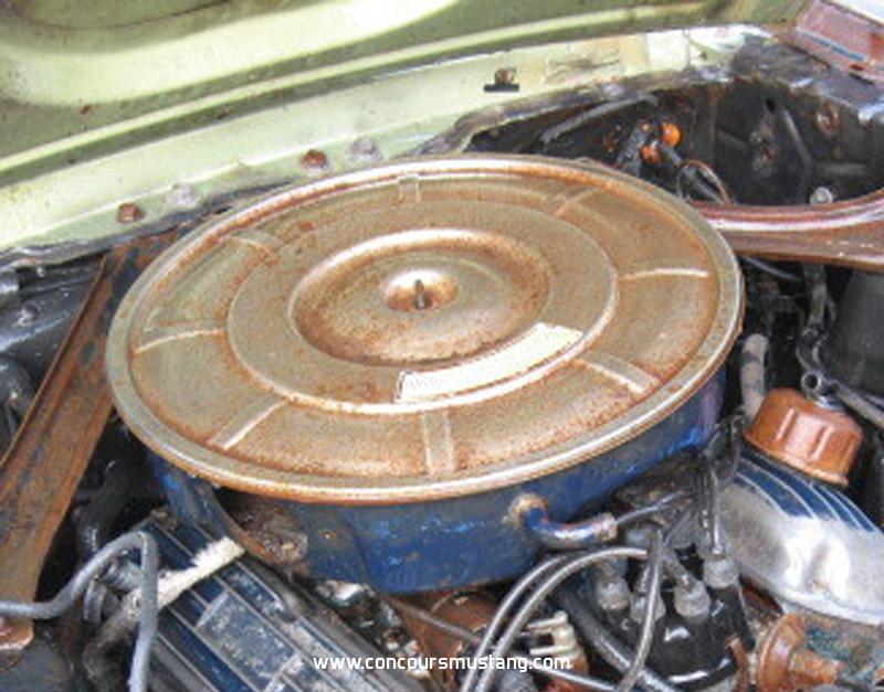

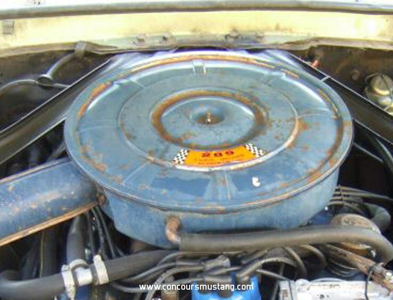

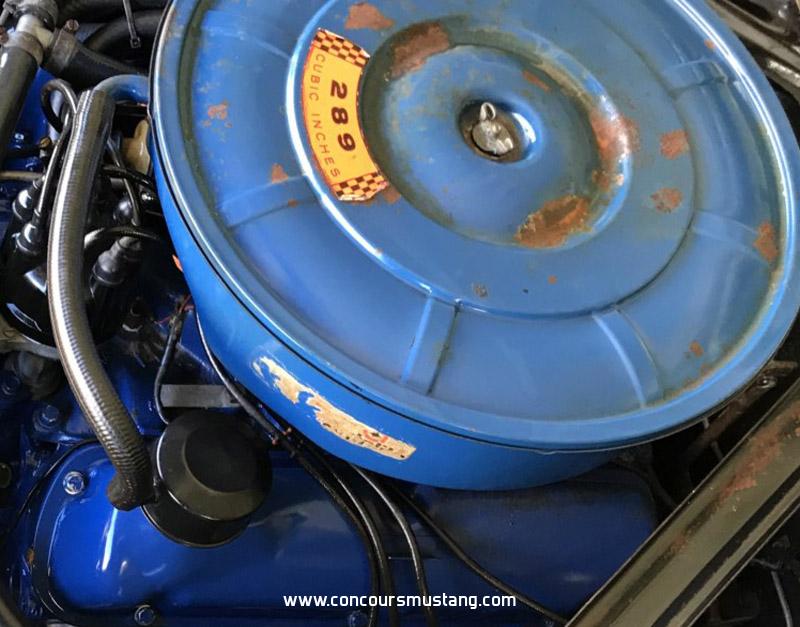

Likely over doing the examples but we're looking for a couple of things. Evidence of decals on the lid and evidence on the base - drivers side. In some (one or more) of these examples the bases have been painted so the shadow is gone on those. So hoping volume helps get a better picture of what I have. Just showing examples with thermactor system and not those without but still built at San Jose that production year though I'm betting they are the same air cleaners for both applications from the same supplier. May have more examples these were already sorted frokm another discussion and investigation
As a reminder or comments all three of the decals were looking for were paper based with a clear coat of very thin film over the paper.
Going to try to post in production order as best I can
7R01C1127xx
7R01A1394xx The lid shows where there were possibly two stickers added to the front. At least one matches in size a state required emission sticker during the late 70 to 80's The other may be another required sticker depending on where this car was licensed, smogged and the system required at the time
7R01C154xxx
7R01C1547xx Base may have been repainted though snorkel and lid look possibly original
7R01C1680xx
7R01C1824xx
7R01C1848xx
7R03C1883xx
7R01C1977xx
7R02A1989xx

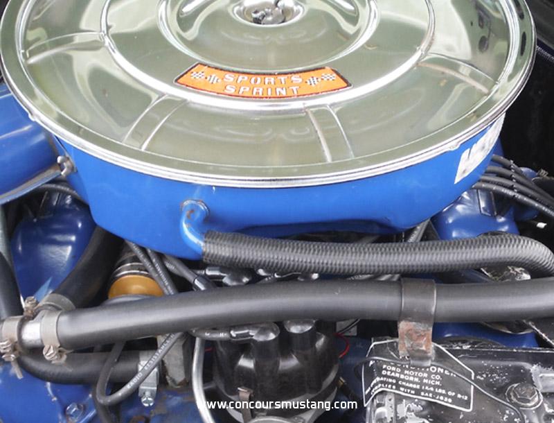

7R01C2043xx Believe that is the Sprint decal and the lid just rotated 180 degrees off. Base has been repainted, notice the wing nuts are,  so any adhesive from the side decal would be gone.  painted
7R01C2053xx
7R01C2071xx

At least we see SOME of a most-likely side decal in this one image. It looks much like the decal on the side of that 390 air cleaner base (picture shared earlier in this thread).

Continuing a look at other threads and the images of both small block and big block examples available so far within this site, it would appear that at least TWO decals were likely used at the location next to the oil breather cap, or side of the lower air cleaner housing. ONE that has the STAR AUTOLITE  logo and the other much the same but WITHOUT the Star in the AUTOLITE side of the decal. Going by VIN production (not actual build dates), as well as what we've all seen on spark plugs, the STAR example is most likely the EARLY version as the No Star version, looks to have carried into 1968 production.
I believe now that the decal I presently have, is incorrect but will wait before looking for any replacement. I did find the STAR version available at MACS. (I uploaded a screenshot of the REPRODUCTION they have)
