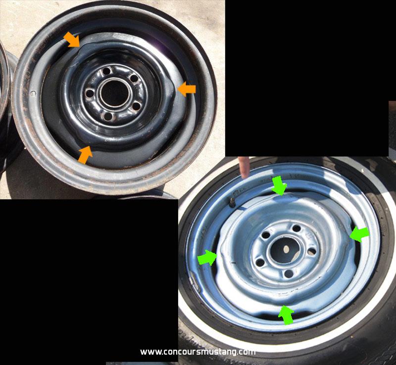

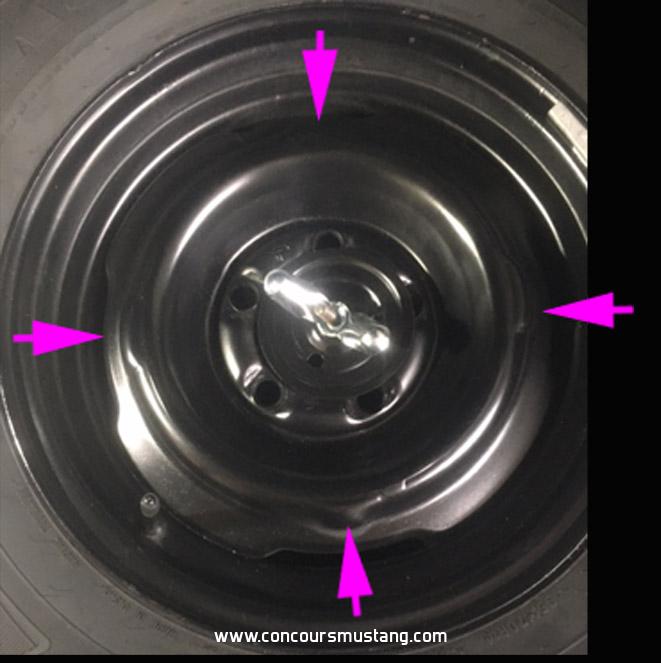

Yes a better picture would help. Easiest way to tell that its not right would be the number of "nubs" that are designed into the rim to hole the poverty/dog dish sort of hubcap to the rim on later Mustangs and other applications

Re: Spare tire wheel type
« Reply #4 on: August 19, 2022, 08:28:01 PM »
Your current incorrect wheel with four bumps for the small hubcap
Upper left general example of the pre 68 wheel. Bottom right a 68-up wheel
All are dated in multiple places (center and rim) but sure that just the design gave it away

Thanks for the example Jeff.
That explains the point on the sheet.

Jeff, of course, is correct about the 3 nubs for the "dog dish" style wheel covers. However, if you get a wheel like the 1968 wheel he pictured, it will be incorrect for your 66. The raised center ring where the holes for the wheel studs are (circled in yellow on the first picture attached), only appears on 1968 and later years. The correct type wheel for 1967 and earlier years, is shown in the next picture.

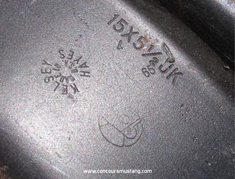

In addition, if you want to be absolutely correct; your wheel should be dated no later than the month of your build date, and could be a month or two earlier. Besides being stamped with the FoMoCo Oval, wheels were stamped with year, month and manufacturer of the wheels. Wheels were supplied most often by the Motor City Wheel Corporation, but also, although not as often, by Kelsey-Hayes. From what I have seen, the K-H  wheels were stamped on the inside bead of the wheel, or on the inside part that is covered by the tire. All of the Motor City wheels that I have seen are stamped on one of the center raised portions of the wheel (third picture). Stamping seems to take the most common form as "x"M"z", where "x"= the year (a single number), M = Motor City Wheel Corp, and "z" = the month (a single alpha letter). Thus, in the first example I pictured (from my January 31, 1967 build 67 Convertible), the "7MA" translates to January, 1967. While this is, from what I have seen, the most common configuration of the stamping, I have also observed it with "number - M - alpha" (the fourth and fifth pictures - "8MF? = June 1968). In addition, I have also seen them stamped with the month first and the year last (pictures six and seven ? ?HM4? = August of 1964).
The years are the actuaJ years, not Model years. Thus, if your 66 was built prior to January 1of 1966, the wheels should be stamped with a ?5?
The 67 Mustang competition suspension cars, including Shelby hubcap cars, got the exact wheel pictured (pic 1) with the 3 nubs and raised center ring. The center ring style with some detail changes from your pic are also used on other Ford full size cars in 67 (and earlier).

Bill : Oh "wheely"? It doesn't surprise me on a car with the competition suspension, as I have never seen one :in person". However, I have never seen that type of wheel with the raised center on a 67 or earlier Mustang, or on any early 60's Ford with 14" wheels, and definitely not on any pre- 1960 Ford. Makes me wonder now if it was possibly a "Plant thing", or maybe a K-H wheel ? Are the ones you are talking about date-stamped with an "M" ?

This pic:
is showing, I believe, a 67 15x6 K/H Comp wheel. It is similar and often mistaken for the T-bird and Lincoln wheel. In fact, T-birds only started using 15" in, I believe, 64 in a 5.5" width.
These are stamped with a 2 digit year, a month (single or double digit), a Ford logo and a K/W stamp on the raised sections between the lugs.

This pic:
Bill : Did you mean a K/H stamp in your post, and not K/W ? If so. this may be the answer to the :raised ring". However, this then leads to the question "did K-H only supply the 15' wheels, oe did they also supply the standard 14" wheels" ?
There are a number of examples of 65-67 wheels with the raised area around the center hub like the 67 mentioned
Here is a 65 example
Bill already posted a 67
