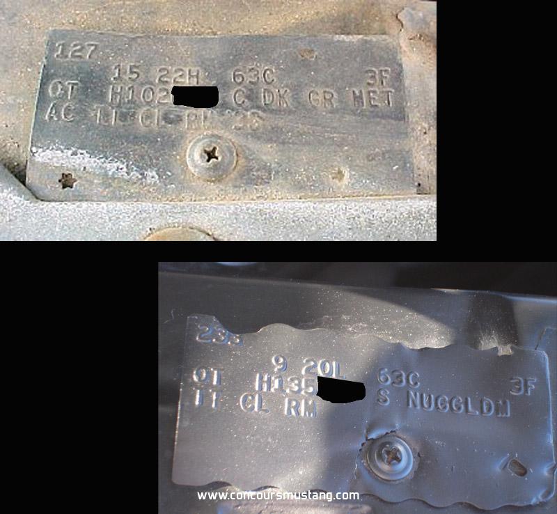

Are we sure the tag shown above is from a 1970 model? I thought that 'TT' (Tu tone hood) was a code used for 1969 Machs.
We need to remember that the codes used on buck tags can and are different depending on assembly plant and year.
I don't have a buck tag that looks (VIN) like the in the original post but do have maybe a dozen or so 70 NJ buck tags with TT on Mach I's
I did find, as expected, the TT being used on 69 NJ buck tags also. TT was not used on 69 or 70 San Jose buck tags. Didn't find that code on 69 or 70 Dearborn but didn't look through all the collection - including the Buck Tag Project of the 90's we did

I checked the In Search of Mustangs database and based on registered Mustangs for both T and F plants the OP Mustang is a 1970 Metuchen built vehicle. Below is the search result for the same scheduled build date.
VIN   Plant   Series   Engine   Unit   Body   Color   Trim   Date   DSO   Axle   Trans   Other
0T05M159039   T   05   M   159039   63C   G   3G   24C   15   6   X

Yes took it that it was a NJ given the reference in the original post of the mistamps found on 70 NJ Mustangs
