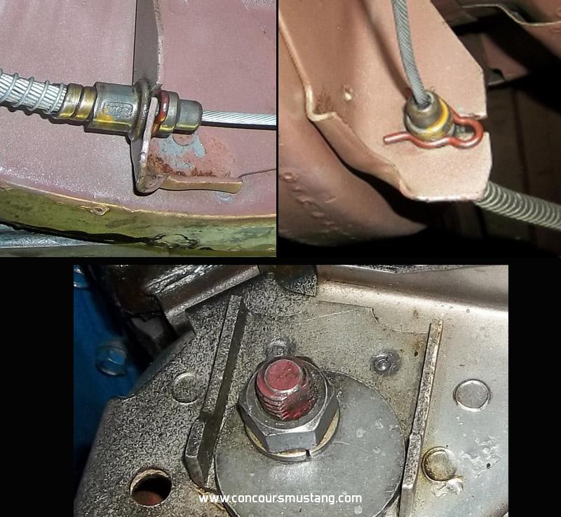

Do have unrestored examples from San Jose with the safety red e brake cable clips as shown below

Have you confirmed that for and on original 68 San Jose built cars?
No virtually every car I restore was built in Dearborn. Even then these parts are normally so rusty they are not useful for reference. Only Metuchen for the '68 Shelbys I work on so no San Jose cars there either.

Great pictures of the unrestored parking brake cable.  I?ll need to add the yellow paint on the cable.  It seems to pretty thin, almost like a dye or wash.

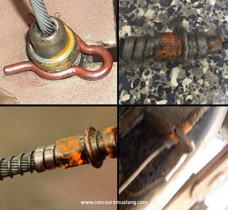

Typically orange. The small sample looks orange to me but that is because that is what I am used to seeing.

Bob got to the orange before I did since I was putting together some pictures  :) All good
The paint mark on the end of the E brake conduit is not a typical examples of what is typically found. Orange is the standard expected mark and was paint. Not sure if the ones in the picture posted above was watered.reduced down too much or simply the worker forgot to stir before they started marking this one - my guess. The orange color mark started in 68 and continued into 69
Suggest you go with the strong standard orange unless you can document a mark that is original specific car
Upper left is a close up of the off orange from the specific car in the Unrestored picture thread

  I?ve got some perfect orange for that color you show correct for 68.  I?m going to soak my original cable ends and see if there is any paint left to match as well.

If wanting to be historically accurate do not make the paint perfect unmarred . The paint apparently was applied to the fittings before they were crimped on the cable. The paint typically had various markings made into it from the crimping on of the fitting process. This is confirmed by the vast majority of NOS and survivor examples. It is common to see them made perfect painted on restored cars.
