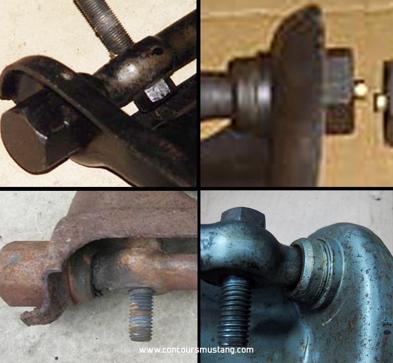

The fact that it has boots and of course the angled zert fittings to begin with so those two details should be seen and found by a competent judges in a concours class IMHO
And of course the fact that the bushings have a hole for the zert would make them not correct for very early cars
Many aftermarket shaft kits included the boots and possibly some service parts so someone may have copied (as often happens) the "improved" design rather than the original design
Would be nice to see a side view to see the shape of the shaft and how its shaped at the attachment points.
Thought they might be Rare Parts reproduction but theirs don't have the boots but they do include zerts - though different shape so you would still need to purchase the plugs
https://www.rareparts.com/MVMS40908-15348-CONTROL-ARM-SHAFT-KIT
Pictures of some originals spanning from early 65-spring 1969. Of course have a fair number more
« Last Edit: October 22, 2022, 04:42:17 PM by J_Speegle »
