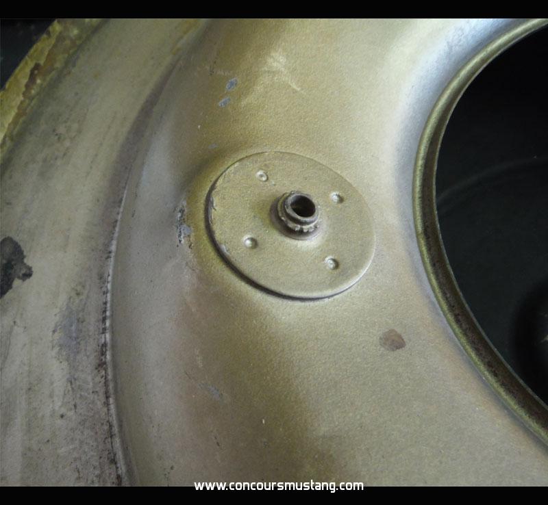

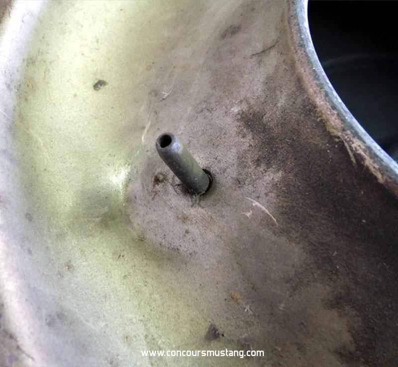

« Reply #8 on: November 23, 2022, 09:08:51 PM »
Some pictures of a small nipple air cleaner base that has been posted in other threads. Ignore the color of course since its from another application. Sam base - different car.
From inside view
