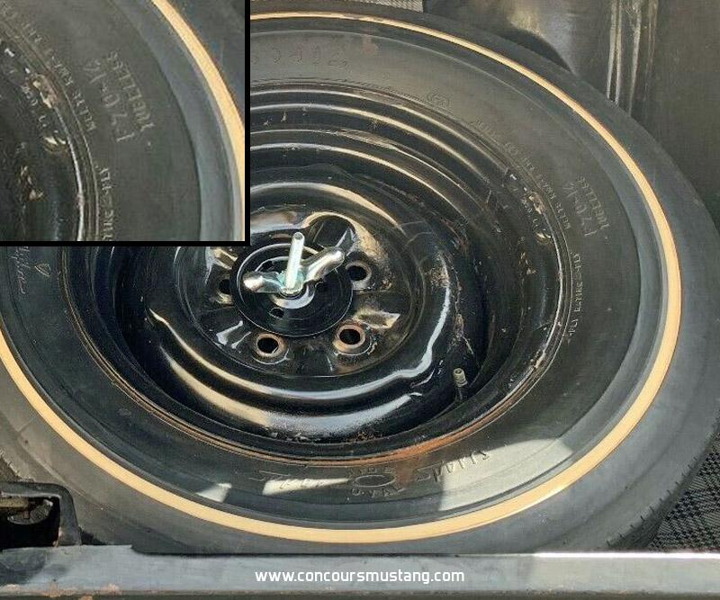

Anyone have F70-14 on the 5.5" Styled Steel Wheel?  Just curious if there are any reported issues since that tire is recommended for 6" minimum width.
Could the question not include other rims that year - steel wheels? Don't recall their width but doubt they were wider than the style steel wheels.
I don't recall reading any documents, recalls, campaigns or such on the F70's installed on 67 Mustangs other than the known clearance problem initially with the front fenders and Ford fix for that. If I've missed or forgotten one sure someone will remind us :)
