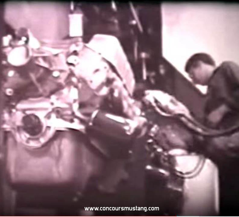

Since the method Ford used to insure the lack of paint on specific surfaces and parts was dealt with using many different ways (masked, not installed, and so on) I think an assumption of a mask being used is a stretch IMHO. Methods also depended on engine size and year as in some cases, an example, distributors were installed later while on other engine types and years they were installed and bagged it appears based on overspray on the housing
We do have pictures of engine oil filters installed at the time the engine was painted with blue paint as shown below.
That discussion thread
https://www.concoursmustang.com/forum/index.php?topic=15273.msg95415#msg95415
