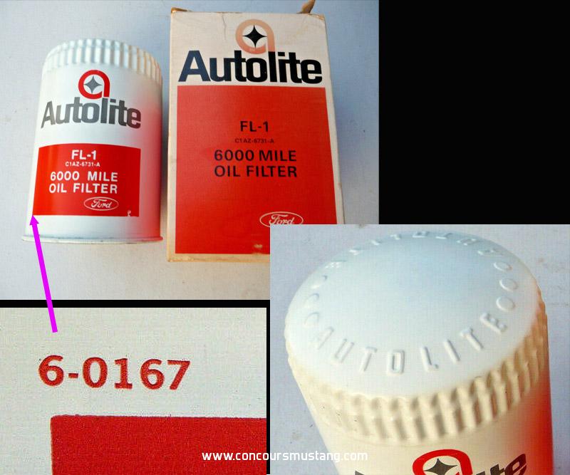

Thinks its best, as suggested, that we don't mix 65-66 details (different color and markings) with other years. In this case 67 but yes agree that the stencil was a early 60's thing that started before 64 and continued to 1966 production
To illustrate some of the details here is an example of one that was painted and labled for sale over the counter. Same base filter just not painted blue like the assembly line ones. Right now could not find any assembly line pictures of the filter on an engine though we have the same filter and process showing on 68's in other threads

Yes I checked and confirmed that the Autolite repros when they were available came with the double crimped flutes and the embossed Autolite on the top (closed end). Ironically the repro MFG marked the box 67-73 even though the highly visible double fluted end was only used through 67 and maybe early 68 production. The filters appearance evolved to a single crimped fluted end with the embossed Autolite after that. That later 68-73 filter has never been correctly reproduced.

Excellent. Thanks to Jeff and Bob I have verified that the versions I have in stock have the raised letters as noted in the pics above.
Since the assy line never had the silk screened logo and such I'll lightly sand the sides smooth and apply some engine paint.
I'll leave the crimp area white. Uh oh. Did I jump the shark on that detail?

Sounds like a plan. The whole filter will be blue once you get done. It started out as a blue filter but I think there can be a case made that that often or the vast amount of time there was enough paint applied during the engine paint process to get all of it coated so at this point would not add an unnecessary detail or trying to leave the end of a light mist of blue over spray over blue base paint.  Guns were flowing and paint was being applied to pretty much everything and anything that got in the way of that effort
