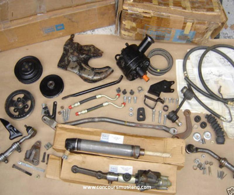

I am in the process of restoring the PS linkage and control valve on my Dec. 1, 1965 San Jose convertible. I was under the assumption the mounting / stud housing was originally natural steel but after disassembly it appears to be originally painted black. Is this correct?

Originally and in add on kits provided to the dealerships these parts were not paint but like V8 units bare steel finish matching their making. Cast steel, formed steel, aluminum and so on
Think someone painted your assembly

It might have been rebuilt at some point or a service piece from later that 66
Think I have pictures of three kits all early ones with the blue and white labels and the finishes are the same. Could look for unrestored car examples but believe I will find the same
