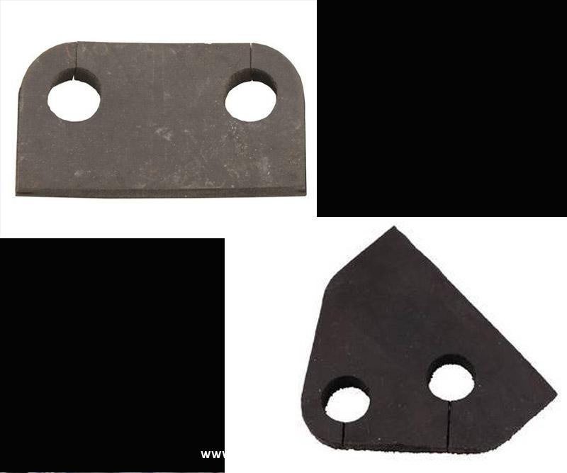

Matt Glad you posted this to the general forum. I know you asked last week about it but searching my pictures it's been very difficult to find clear pictures that will show this detail with the car assembled.  The difference appears to be in the orientation of the both necks that connect the hoses to the evaporator and in turn differences in the seal and the AC/heater case not visible with the case installed in the car.
The two pictures below illustrate the differences in the seal and in turn the cutout in the cases between the two. Pictures borrowed from NPD - THANKS. Upper left the earlier 67-69 style and the lower right the 69-70 style

« Reply #2 on: January 17, 2023, 03:37:54 AM »
Thanks Jeff!  I have the one in the top left and I had no idea what it was for!

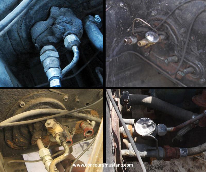

After looking in to a question I've not heard of before I think its going to be difficult to determine when the change over took place at each plant. What is required is pictures of observations of the AC/heater case from the firewall side and/or clear pictures from a good angle of allot of passenger firewalls.

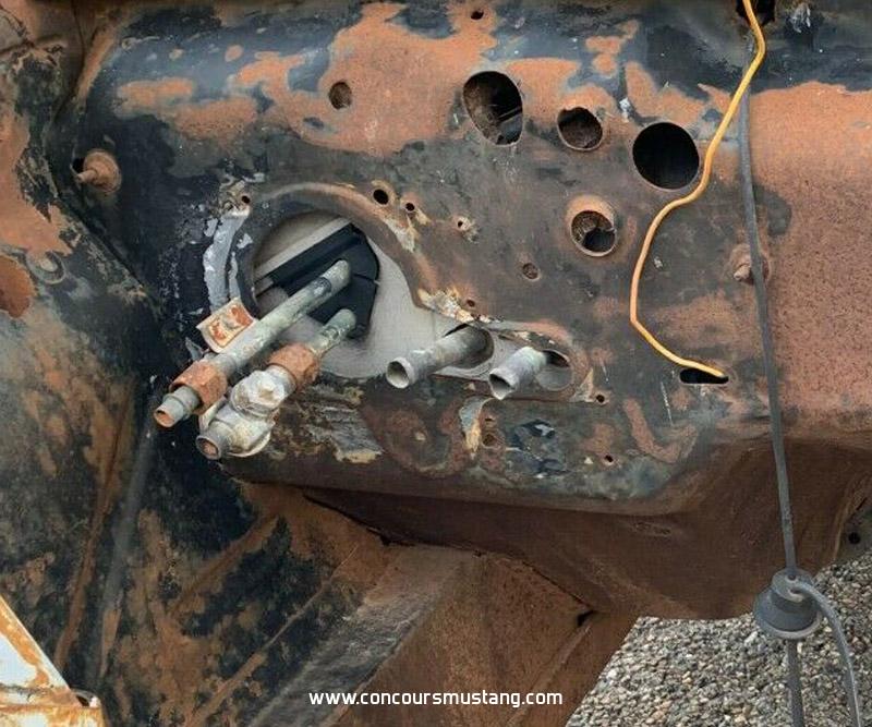

Looking through my pictures I could only find one that had the outer opening trim removed allowing a pretty clear view of the attachment points and seal on the case
69 Dearborn Mustang built likely the first half of May 1969 with the "late" version. Have the tubes orientation vertical from one another.

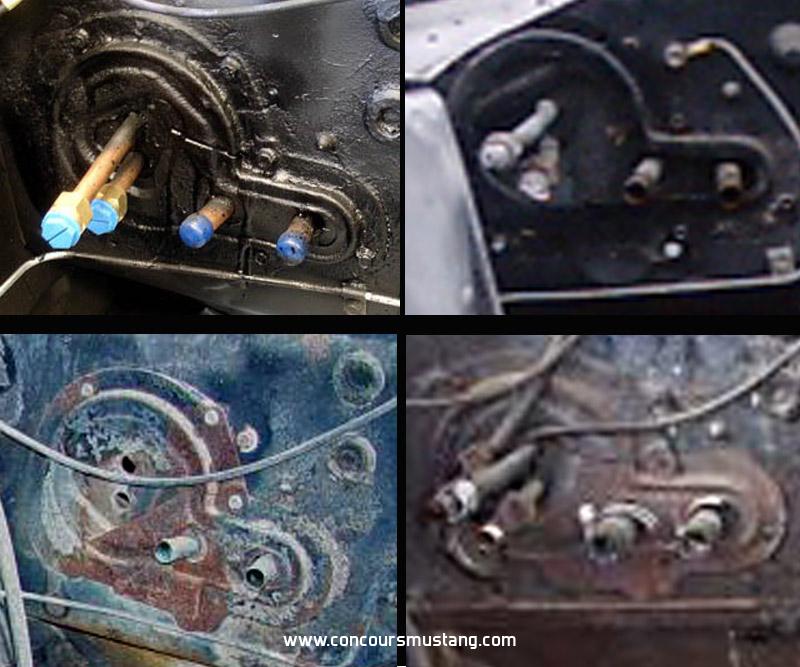

Set of pictures showing the AC line attachment points being vertical from one another. Possibly the "earlier" version
Examples from 69 Dearborn built 4/2/69, 9F16089x, 9t19666x 9f13488x
A set of pictures showing the attachment hoses at an angle that appear to match the first picture orientation of the tube ends at the case.
Examples from 9R11107x, 9R14025x, 9R11446x, 9R11485x
Drawing no conclusions at this time. Just offering examples for discussion and observation

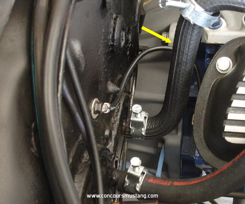

1. Where is water heater valve placed on 69? Is it secured to firewall like 67-68 model?
No not secured to the firewall like 67-8 but sort of "floated" at the rear passenger side of the engine. Location and landmarks differ depending on which engine car car came from. On V8 cars the hose (preformed rigid S shaped) from the firewall/heater connection held one end and the bulk heater hose held the other.. Valve is pretty much all metal (main body brass) unlike the plastic replacements you often find for sale on the internet
A shot of an original S hose as described above

Pics that you included Jeff appear to be all late designs. My conclusion of timing of evap conversion period being Jan was based on few observations. Other Gentleman on this thread indicated he had Feb built car and has late design. Even though my car has all the underdash components gone, the evap/heater brackets that attach to firewall is still present. There is also difference in early brackets vs late model brackets. Late model opening is triangular in shape which is consistent w mine so I can assume that Jan used late design but can?t guarantee the switch was not in middle of month. I met guy at car show who had Nov built Dearborn 69 that had early design configuration. Missing link at this time is what happened in December. I know I shouldn?t assume but I?m betting December used early design and Ford made switch in January?? no hard data to substantiate it unfortunately until a Dec built car w a/c is made available. I would imagine concours judges for 69-70 Shelby?s may know the answer bc points would be taken off if wrong evap was in car which is easily visible. bigger question is why did they feel need to change engineering of the core??.. crazy times at Ford back then. I personally feel vertical lines are PIA bc it?s difficult trying to tighten lower hose to evap when 428 block is in car. Horizontal lines would seem easier like 67-68.
