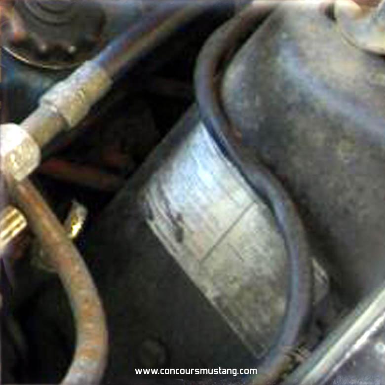

Starter finished incorrectly. Like others the black would have faded to almost nothing at the attaching base while trying to assure that the main steel body was coated at the same time as another possibility by 70 one mounting ear may have been masked off to ensure a good ground.

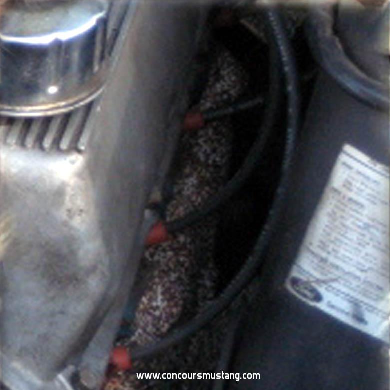

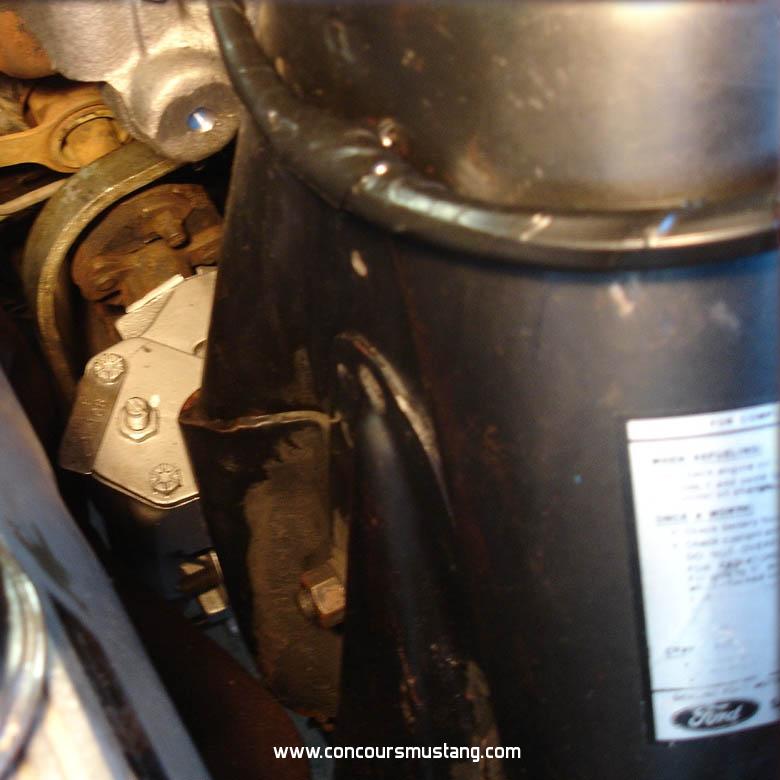

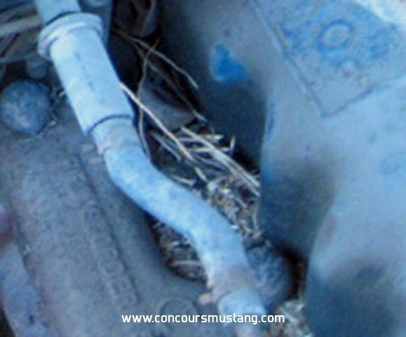

A couple of pictures of another car. Like yours there have been some changes since new. Looks like someone also replaced their water pump and didn't worry about painting it either for example

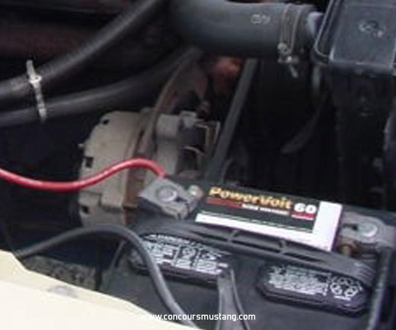

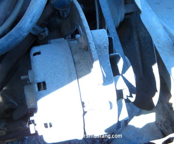

A close up of the alternator Rounded back AUTOLITE cast alternator not that GM looking thing you's currently or did have

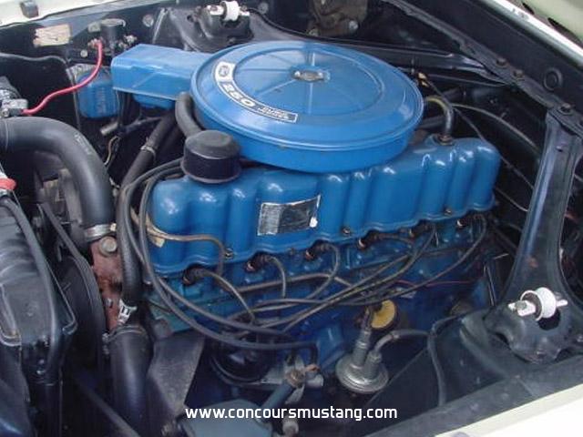

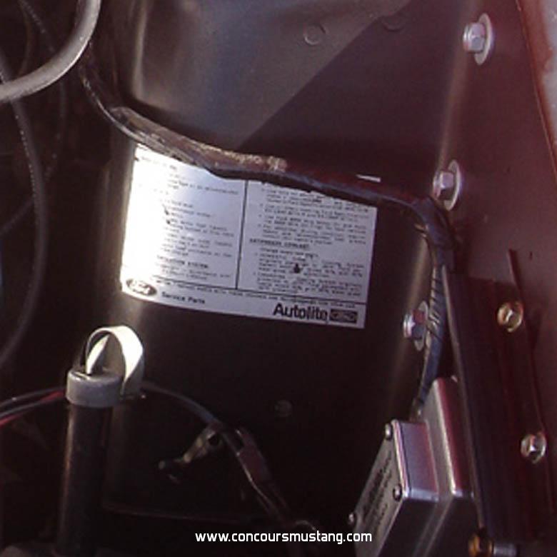

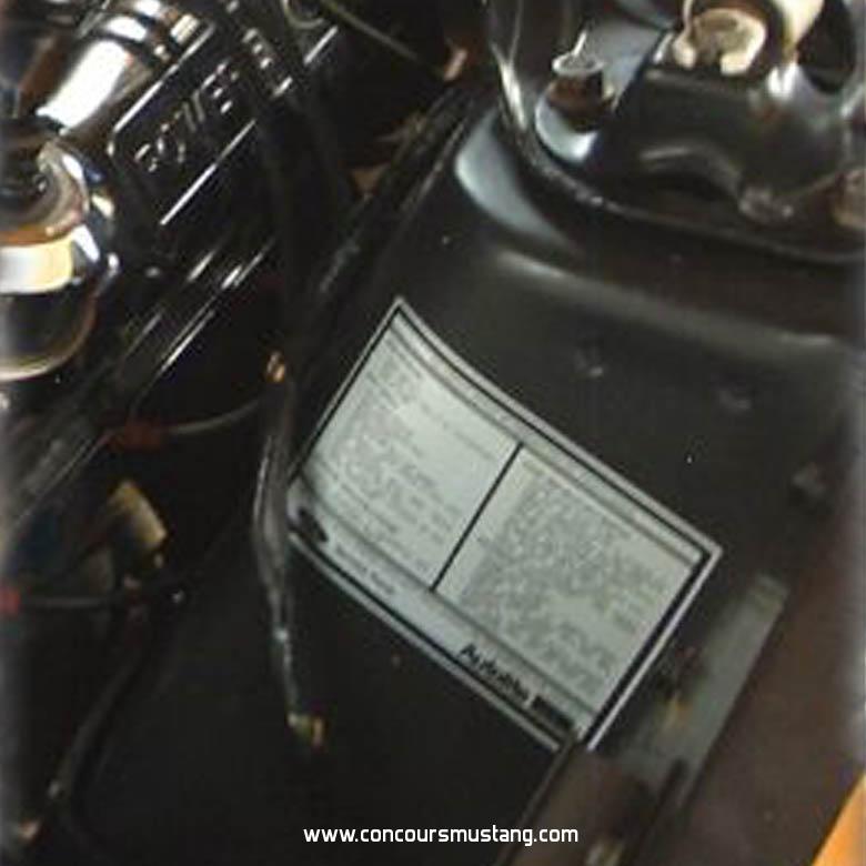

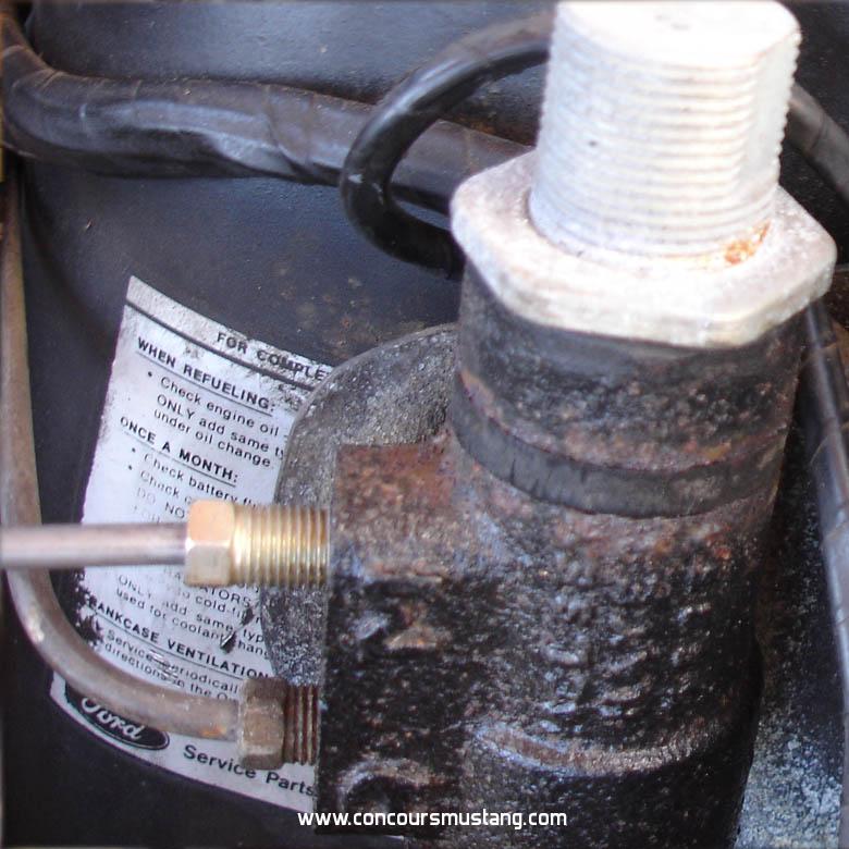

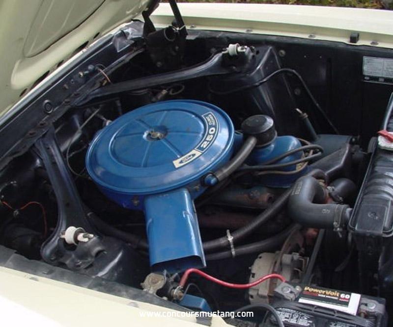

And just maybe for a little help in some way a couple of pictures from a 69 examples
Believe yours would have come with a filter at the carb like the example below since there was none in the rest of the system
Also if you haven't noticed yet no worm clamps were used originally on hose or flexible line
