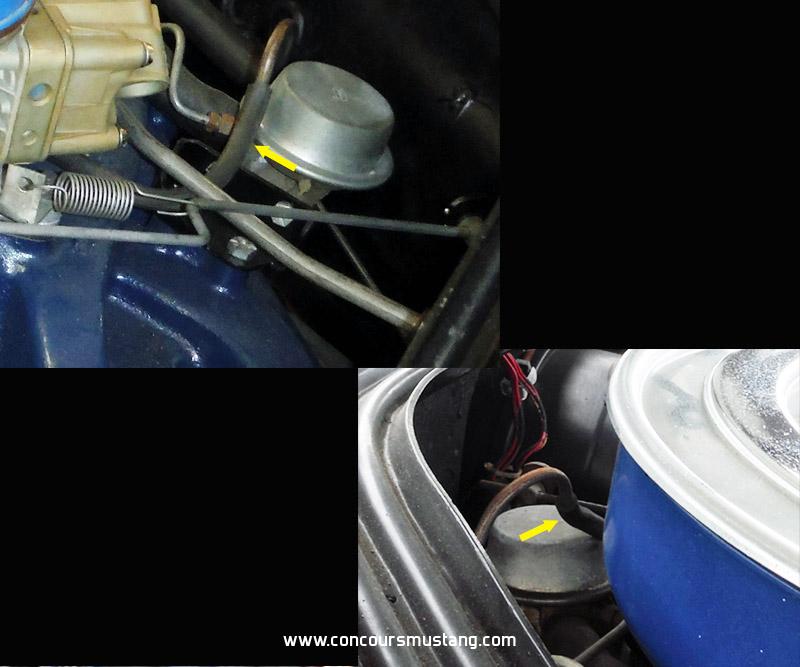

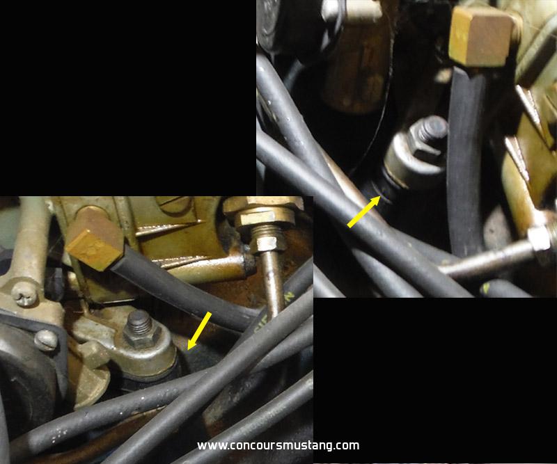

There was the spacer still looking to see what one was used and if it was attached (vacuum line wise) to anything. Pictures are from  a thread in the Unrestored picture thread that focuses on a late 67 San Jose 390 with Thermactor that was unrestored

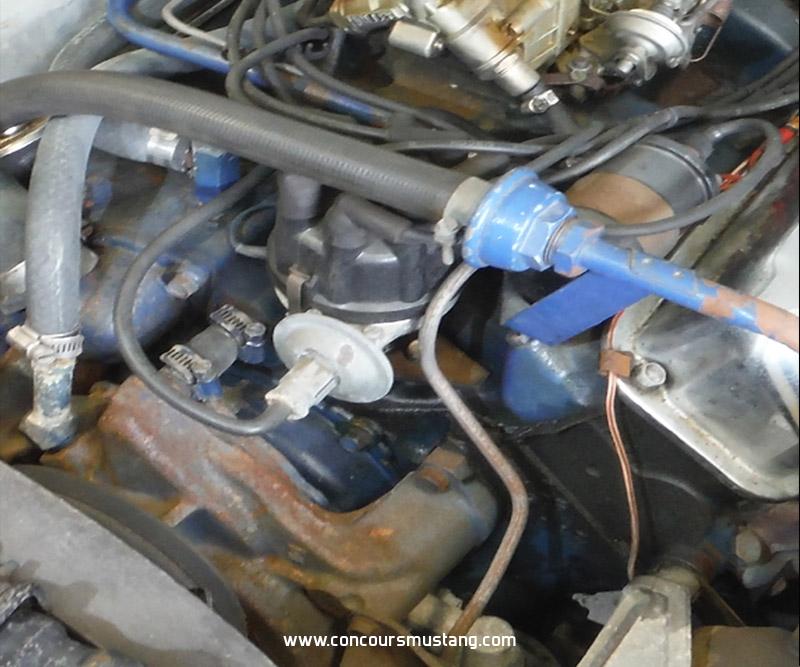

As for the routing from fuel pump to carb its shown in the picture below basically. Attachment to carb is the typical solid in, short piece of hose with band clamps (not the replacement style show) and them to the filter attached to the front bowl of the carb

Here is a before and after picture from the example shown/mentioned above showing the hose and routing
