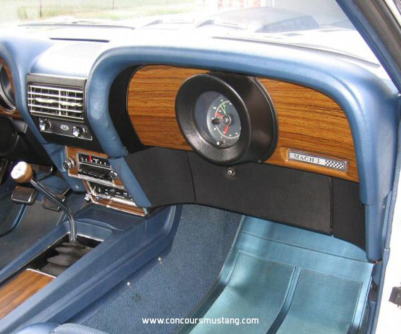

Example of a 70 Dealer added AC. Have seen about four of these systems. All the working are on the passenger side of the firewall like the factory but conflicted with the clock option

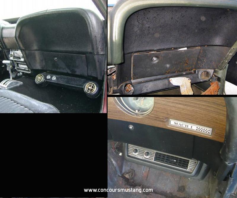

Three examples of add AC systems (passenger side) in 69 Mustangs Believe the upper left is the Ford supplied Ford dealer add on systems and possibly the upper right a different version

+1 . A dealer add on A/C would certainly not be a very close duplication to a factory A/C install. As the picture that Jeff posted shows ,besides the  obtrusive clock extension needed for space behind the dash the factory add on air does not include the lower air registers which are made into the lower dash of a factory A/C car.
