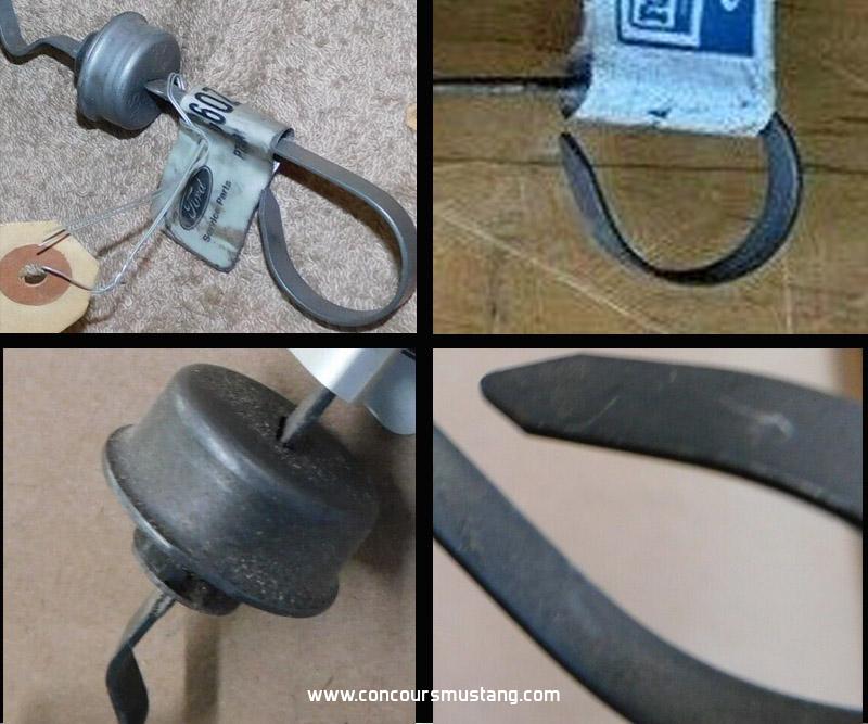

I held back from posting the examples below since we all realize that service replacements can have different finishes and look (as well as the whole picture/monitor things) but here are three examples. The upper left is a blue and white early label NOS/service example from likely 65-67 and the other three are later service parts from the late 80's or much later.  To me it appears that a phosphate or similar treatment would likely reproduce a similar look depending on the lighting. In some it appears zinc phosphate while in other pictures magnesium phosphate would be a better choice

Of course when the car were being made a portion of the parts were directed to the service line to supply the dealerships and their needs at the same time the cars were being built. The reason the upper right example was interesting and a nice IMHO find to include in the picture set since it was likely one of those types of parts
