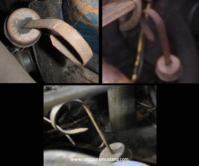

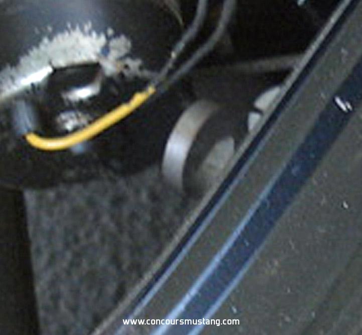

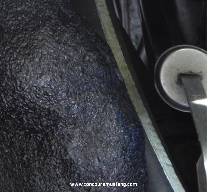

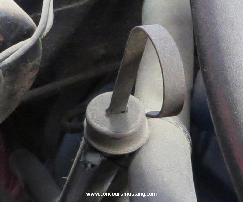

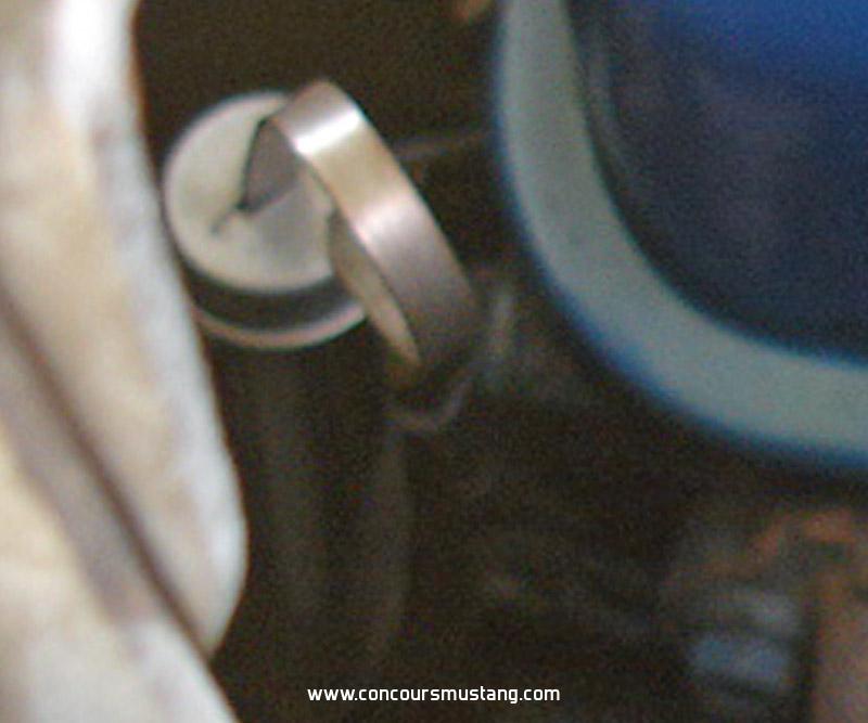

A few pictures from pretty decent examples (given the years of use).
Spanning 7R13xxxx-7R19xxxx
Please ignore the black zip tye  ::)
As a side note a few very nice 68 examples appear to have some sort of plating  though I think they are the same part number
And while we were on the subject and others will likely view this thread when it comes up in a search of "C4" details, here is a few shots showing what the end of the handle looks like.

Looks very familiar.  Thanks!

To me there appears to be some light plating of some form
Example on the top one there is a spot at 6 o'clock that appears to have been rubbing on the edge of the base cap where that created some surface rust while the rest of the cap shows nothing. Not sure what the plating would be but it appears to be lightly applied and didn't hold up as well as some other plating on parts in the general area
Just an observation

Other year automatic dipsticks I have observed had a zinc phosphate coating/finish on the top and finger pull. I strongly suspect that is what is used in this case.

I would agree that zinc phosphate coating was used. It quickly deteriorated and rusted.
