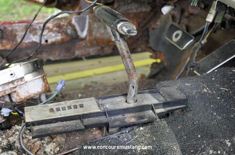

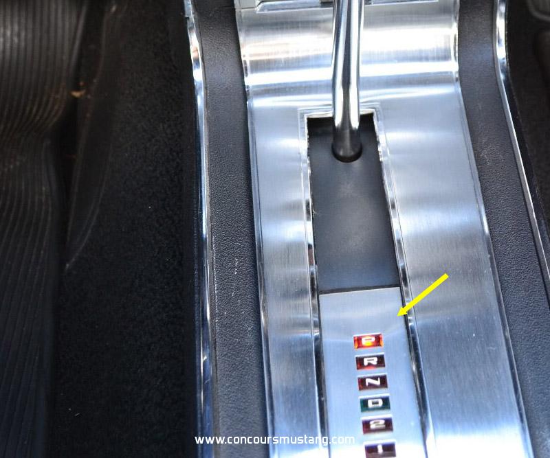

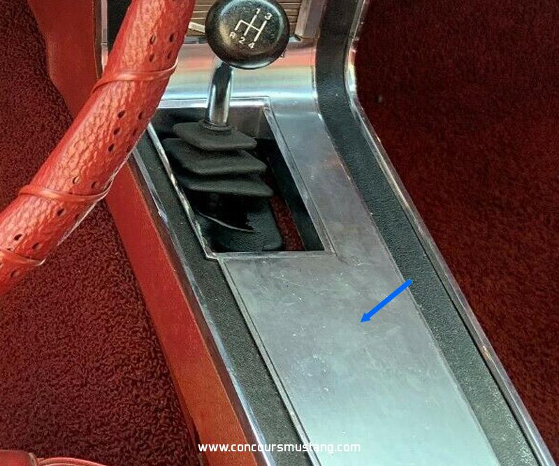

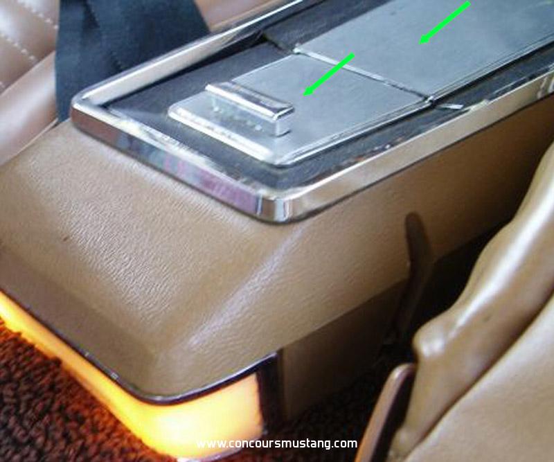

I was confused about exactly what was being described so stayed away earlier in the day. I too believe, if I understand the sections your referring to, that those are all one piece sections with the details, including what your asking, are cast into and finished
A few pictures to illustrate some of the features  notated by the colored arrows to help the discussion. Some of the others may have been thinking of the automatic insert (yellow arrow)  that is an add on (glued down) feature but will let them confirm or clarify. That panel is glued to the sift indication that is attached to the floor not the shifter bezel

« Reply #11 on: March 01, 2023, 03:00:38 AM »
Yes Jeff....green and blue arrows show what I was asking for.
Thank you.
So, no way to pull them off.

I forgot to list this item. This is the only console section with brushed aluminum inlay insert. Clearly, only on automatic transmission examples.
