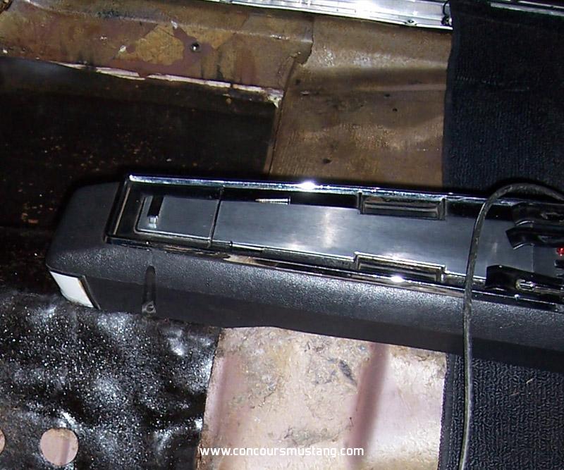

I am trying to confirm where the cuts should happen on a center console for a Convertible.  The console was sourced from a Coupe/Fastback.
You will need to find someone with a convertible to trace or make a pattern from an original then use it to trim it to fit a convertible. Yes they are different based on the picture of the convertible with console below. If you find one or someone has one I would like to get a copy so that it can be shared here with the members.  Start putting some wanted ads on this site and other with high traffic. I don't recall anyone ever offering these though have seen 65-66 convertible patterns but they are not the same

Here are some photos of the templates I made from my original 1967 console.  You basically need to remove a small section of material on each side of the console between the screw holes.  The tops of my templates should both be lined-up along the midline creases on each side of the console.
It's probably easier to see these templates/photos by downloading them first and then viewing the files with a picture viewer.
Please feel free to ask me any questions!

Excellent! You included reference measurements.

Paperback Writer I used your template yesterday and it was perfect.
Thank You
