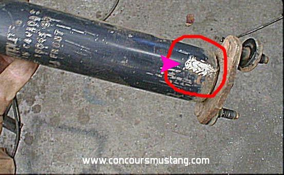

Would you happen to have a picture of an original front shocker to suit my application?
Don't know if this is the correct engineering to be for you application and typically the Made in Canada version here would not be correct for a San Jose though it does show a white paint daub identifying it as most likely one that was used on a 69 351 Mach I and other applications
