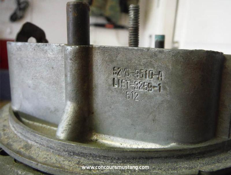

I've seen a few carbs online/auction for sale and was thinking of getting one as a back-up but don't want to buy an old repro by mistake due to the high prices. Anyone have images of 1966 Shelby carb's (non-hertz) where the ID (model, date codes) stamps are so I can look to compare what's in these auctions.  Thanks in advance.

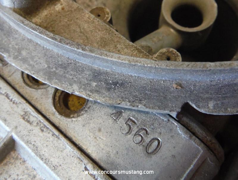

« Reply #2 on: April 03, 2023, 08:13:10 PM »

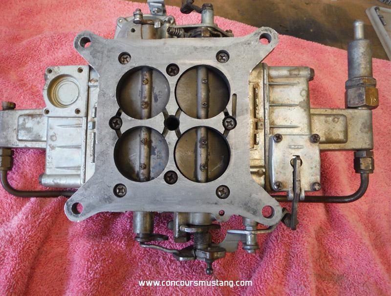

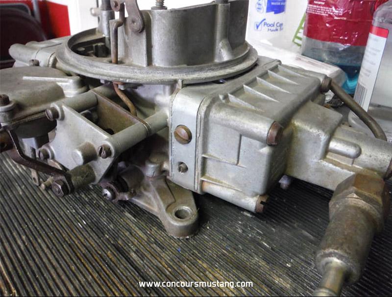

Here is a few pictures of one dated 612 I had a while back. Please ignore the owner added stud on the accelerator arm :)

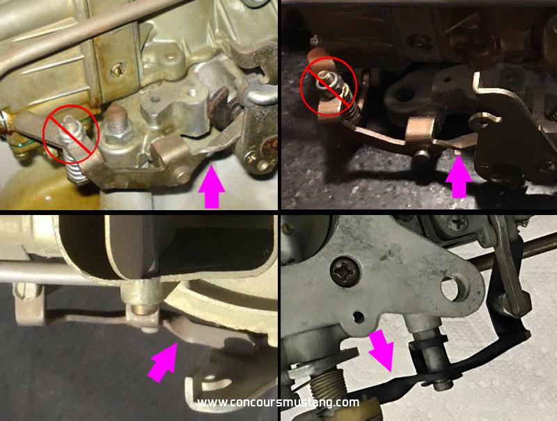

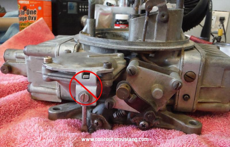

« Reply #3 on: April 03, 2023, 11:00:05 PM »

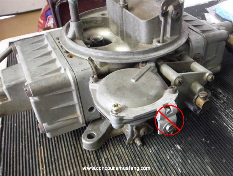

Jeff, yours has the wrong accelerator pump lever.
Clip for choke cable is on wrong side too

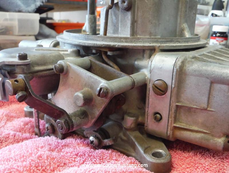

« Reply #4 on: April 04, 2023, 12:15:11 AM »

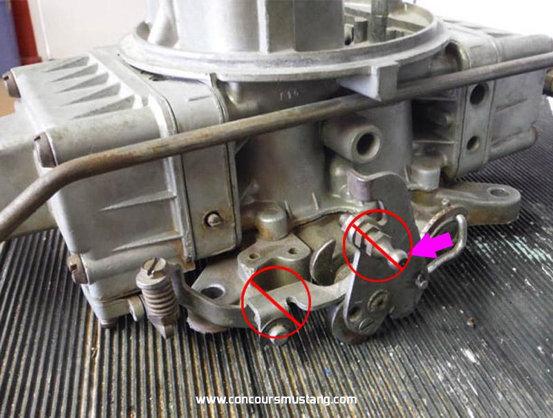

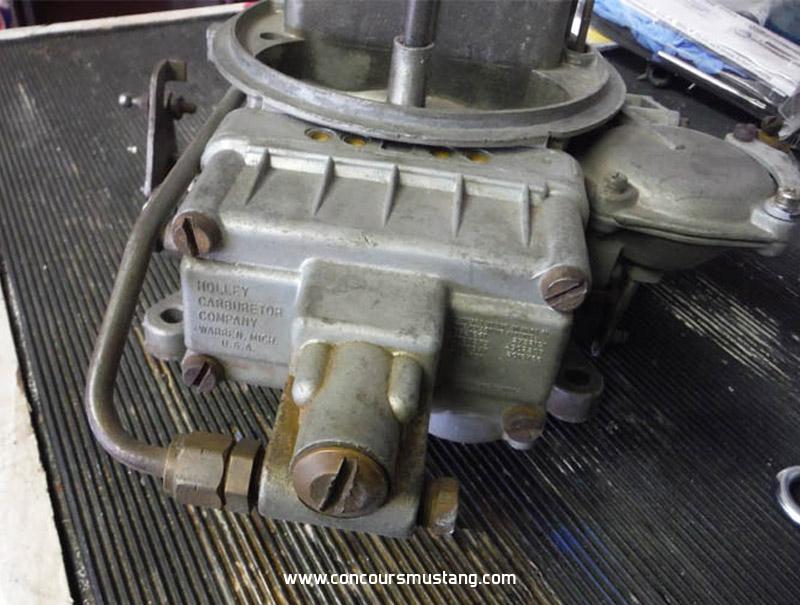

Yes certainly was missing the twist in the pump arm. A few examples of the correct version
Not sure why the guy put it back on the backside but a few pictures to show the correct orientation for the viewers

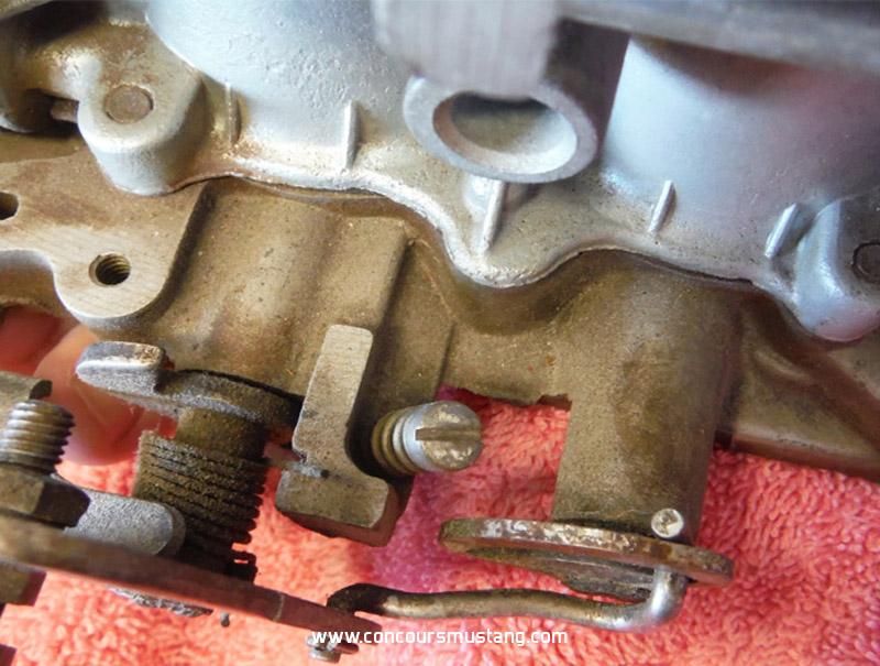

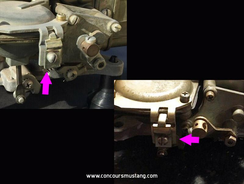

« Reply #5 on: April 04, 2023, 09:07:51 AM »
The pump override spring screw is like the later photos of yours. The long screw and nut is a later reproduction.

« Reply #6 on: April 04, 2023, 09:48:35 AM »
I would not expect a 1963-64 brass spark vacuum plug in that 1966 time period. Plated steel in the same design would be what I expected.

« Reply #8 on: April 04, 2023, 05:28:34 PM »
Highlighted details in my earlier pictures to hopefully help.
Dan to tell the finish in may of the pictures I have when it comes to the vacuum plug. No rust on any of them in the 66's I looked at and a few of them might be brass due to the screw driver damage. Will keep an eye open for more examples in better original condition and cleanliness
