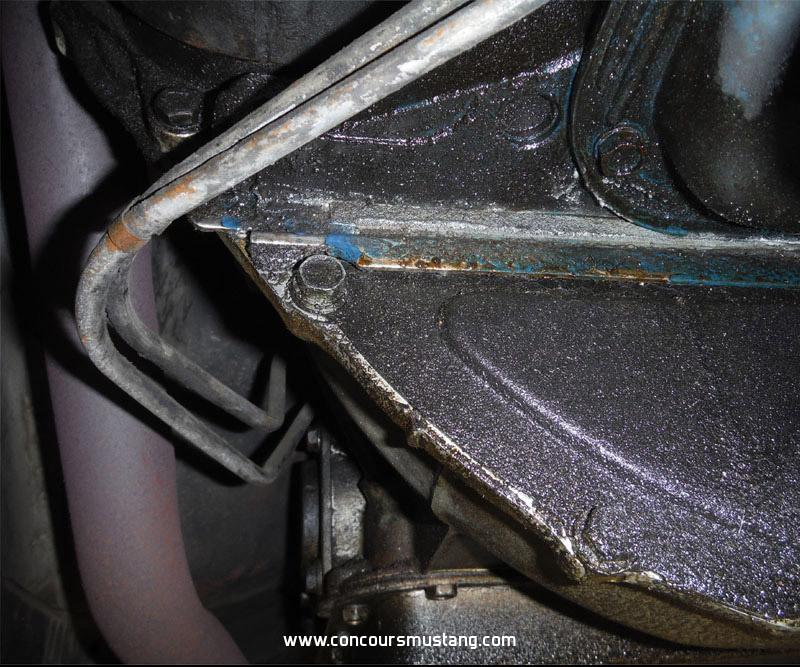

Inspection cover is semi-gloss black on all surfaces
Sorry is a bit dirt but original and the paint as well as other details are visible
Addition pictures are in the unrestored picture threads - identified as a late 7R207xxx S code San Jose fastback if you want some additional pictures of details. Many relate to your car aslo

Thanks for everything Jeff. I appreciate for helping me.
