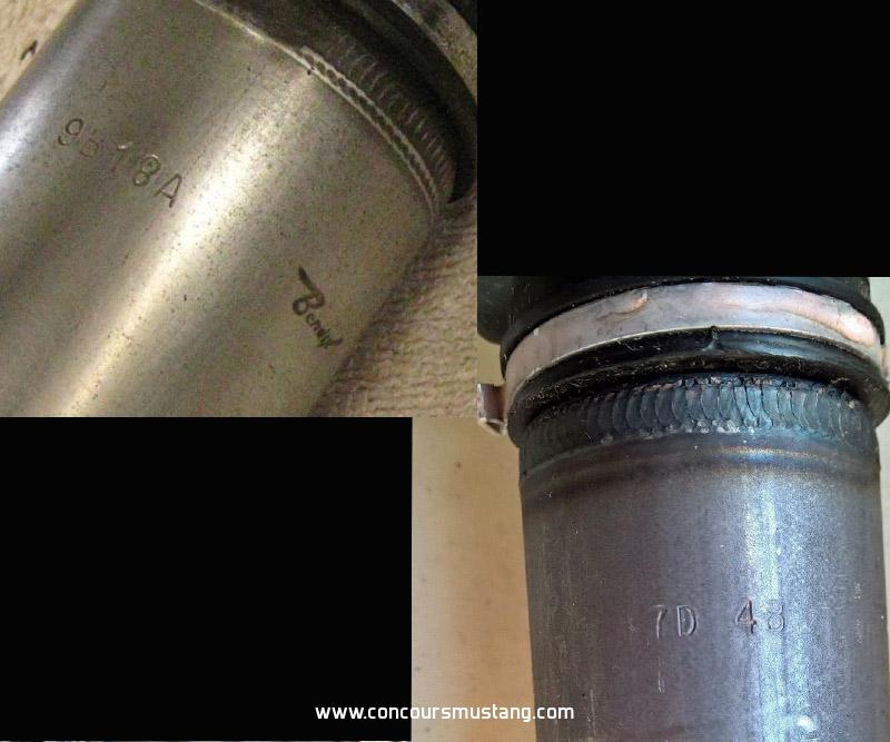

Here are two examples Upper left from a 69 and lower right shows the date on a 67. Both are stamped on the end of the ram that attaches to the center link

I had to use a 3/4" ball joint separator to get it out. Stuck in there good. I now see, in addition to the 128551 code, the Bendix stamp and the code 7A19A. Kind of surprising given the Shelby build date of 1/27/67. I think the code means 1967, January 19th? Not sure of second A. Maybe shift? The cylinder retains the black paint on the upper half of the cylinder. None on lower half facing road, but no rust at all. Clean, rust free shiny ram.

Yes given logistics a very close example of just in time inventory. Yes road wear has taken off previous owner added paint. Originally there would not have been black paint on upper or lower half of cylinder.

That would be your Ford/San Jose build date not the Shelby one ;)  And I believe your a day off. Things I'm looking at show Jan 26th not that one day makes allot of difference
