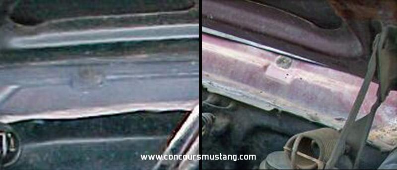

Often have found this a difficult thing to document since the dum-dum hardens and can become dislodge. Also IMHO there is the possibility that Dearborn didn't start out using it with or without the nozzles but a look at their practices with the 64 Falcons and other models to see what they did on those earlier car and in turn that should help understand what their practices were by widening the search pattern
Just to ad some more to the discussion and focusing just on 65 Dearborn production. In full disclosure the pictures are from 5F08A7404xx and 5F07C7396xx in that order
