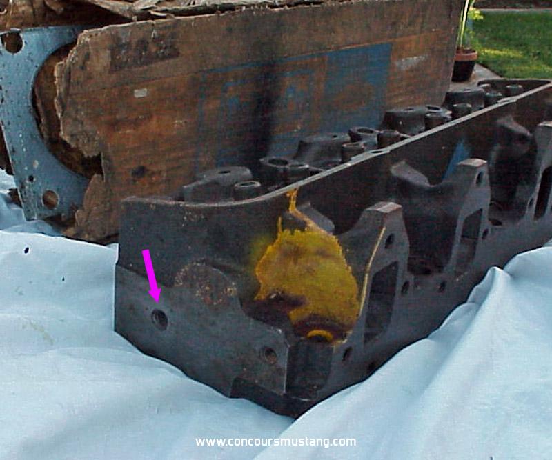

« Reply #2 on: April 30, 2023, 05:20:23 PM »
Believe this is the hole. Do agree the Assembly Manuals can help allot just double check to make sure the information applies to your car and when it was assembled.
