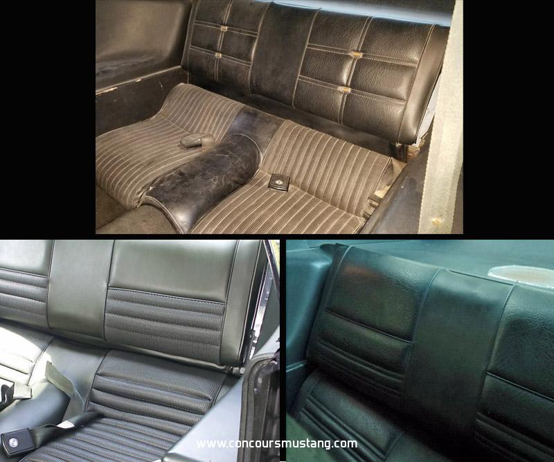

I have owned a few 69 and 70 FB but am confused on these seat cushions.
These apparently came off the same car, but Im not familar with this mis match pattern.
Both metal tags on the back have C9ZB numbers with matching May 22 1969 date codes, also on the upper cushion within those tiny rectangles there is wood grain decal , and the lower cushion has comfort weave.
Can anyone confirm that these 2 different styles were used together ? If so, what vehicle or interior package

Looks like 1970 (EA) Black Clarion Knit/Corinthian Vinyl Bucket Seats with sports deck rear.

So am I correct to say it is correct for any 70 sports roof with deluxe interior
and not correct for Mach 1 because the Mach 1 pattern was different ?
Re: 69 / 70 FB Rear Seat Upholstery Help
« Reply #10 on: May 22, 2023, 07:39:27 PM »
Yes and yes though the seats could be reupholstered and the springs reused for other applications
Top example is coded EA and is for deluxe interior
Lower left is a Mach I style and the lower right a standard interior example
