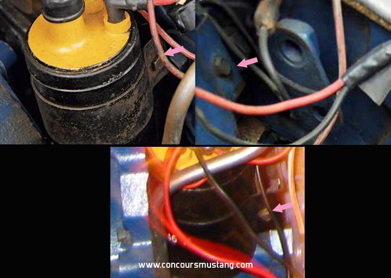

What hardware and orientation is correct for the coil strap.

Here's a resized picture. I think the bracket should be phosphate & oil finish. The screw should be bare metal. Nut is zinc plated.

Thanks RoyceP. Is the orientation of screw and nut correct in the picture you resized?

Yes
Often you can find the "screw" and nut reversed on 70's. Allot of the unrrestored pictures I have have them that way. Also the hex headed "screw" head were also used that year. Might be the first year for those but have not done a full look at all 70's since they would all used similar hardware since they shared the supplier most likely. Sorry I didn't find any more examples in my quick search. Too many PS equipped cars  :(

Thanks for jumping in. I love this data. I find these details such an interesting element of the hobby.
Pat
Now on the hunt for that hex headed screw.
