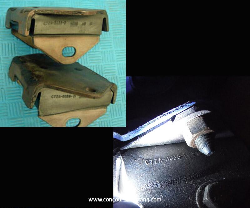

« Reply #2 on: June 15, 2023, 12:27:31 AM »
 I recognize the pattern of my blue judo mats on the upper pictures Jeff posted. I still have the C7ZA mounts. All of the ones that I have ever seen were blacked out or at least thinly painted black with the exception of the lower ears as seen in the picture which were bare steel.

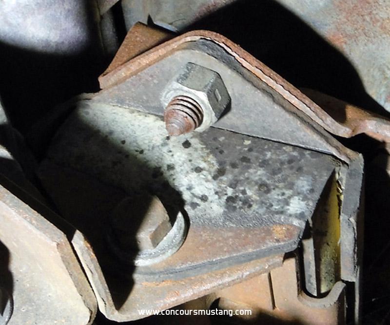

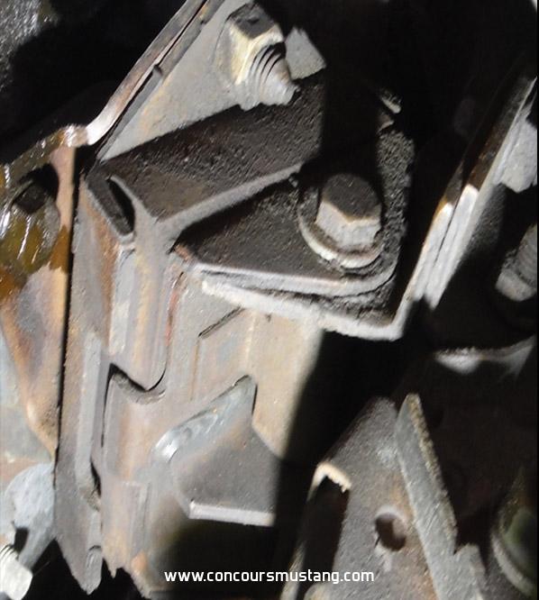

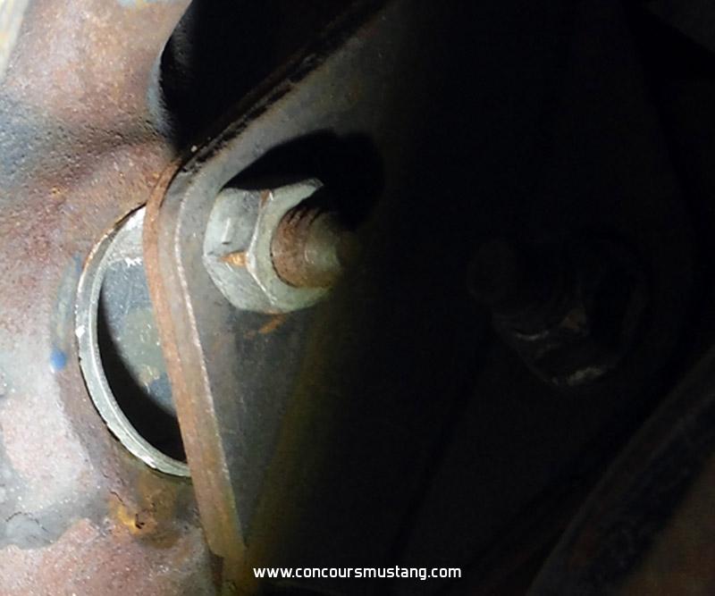

« Reply #4 on: June 15, 2023, 04:38:33 AM »
Here are a few more of this late San Jose built car that I shared pictures of in the Unrestored Picture Thread section
On the drivers side the lower steel section didn't get much if any black but the edge suggest that it might have gotten some.
Close-up of the black paint
On the passenger side that surface may be dirty or have some - just didn't clean it of that day to see and take a picture
This picture is "neat" IMHO as it shows that even after 50 years you can see of the surface difference in the natural of the motor mount to body bracket/mount where they were welded together. Hasn't even surface rusted in those area after all these years.
Pictures also help with some of the possible hardware questions others may have.
