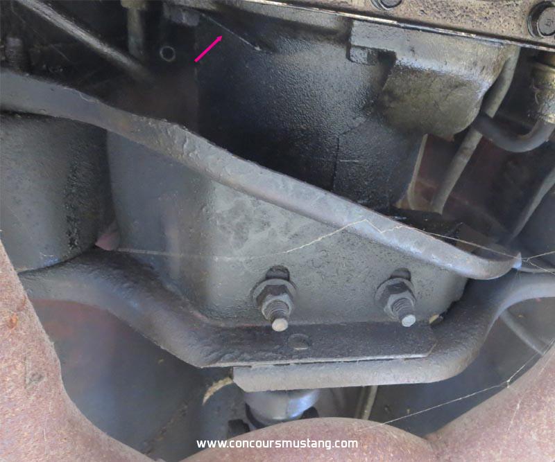

Hi All , I am looking for the FMX tag for my M code 70?
Has anyone got any pix on code I should be searching for?
Did the (70, built late 69) Cleveland FMX 4BB exisist?

PHB-P Would be the correct tag for a 1970 351-4V FMX.
+1 They are attached in a terrible location to get a picture of

Interesting .. I noticed engine tag K609A on that built sheet?
Mine has a "G" after ie K609AG.
is this still valid for me? I put decal K609AG on my valve cover
Enclosed is the photo of engine tag and also see  link http://1970mach1.homestead.com/3514VC.html
With the built sheet
Should I be looking for a transmission  tag  PHB P 953A?

The G suffix on the engine tag indicates air conditioning only. 953A is the rear axle tag plant code, which is on the axle tag, not the transmission tag. It corresponds to a WES-AB, a 9", 28 spline, 3.25 open. Yours may be different.

No The "953 A" on the buildsheet relates to the rearend identification not the transmission in any way
