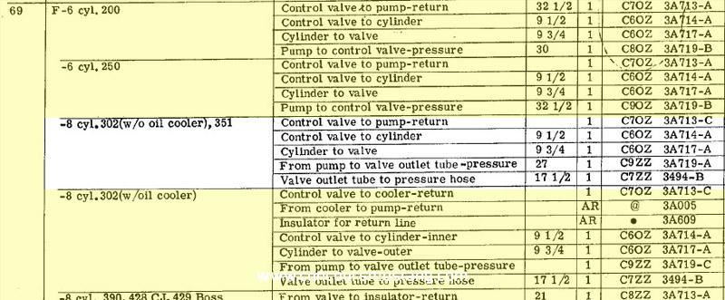

From a late 69 MPC. As a reminder for others the oil cooler *listed below the wo/oil cooler group shown below, was not an option nor available from the factory on production 69 Boss 302's, so can't explain why Ford would list it other than just an error/miscommunication. Since Ford was always consolidating parts to reduce the need for additional inventory we can't be certain that the part numbers shown are the exact ones that were installed on the line, even only a couple of months after production had ended.  Guess another place to look is the Assembly Manual reprints but don't know if they list the application
Sorry don't have a MPS printed between May and Aug 69

I believe the MPC is referring to with and without "POWER STEERING OIL COOLER".  In the text for the 69F 302 "with oil cooler" the MPC includes line item part numbers for the bulk return hose and insulation used with the power steering oil cooler. The text for 69F 302 W/O oil cooler does not include those items.  My extra NOS 1969 Boss 302 Power steering Pressure Hose is Tagged C9ZZ 3A719-C...... the engineering number stamped on the fitting is difficult to read (chokostang shows a photo of the eng # as-D).  The length of this hose is definitely NOT 27 inches as the C9ZZ 3A719-A (69F 302 W/O Oil Cooler).  If anyone would like detailed photos or measurements of installed system or loose NOS hose I can supply..... To my knowledge the C9ZZ-C hose has not been reproduced and is very difficult to find NOS or used!

I believe the MPC is referring to with and without "POWER STEERING OIL COOLER".  ......................
Were 69 Boss 302's with PS built without the oil coolers for PS ?  If so, when and if we know, why?
