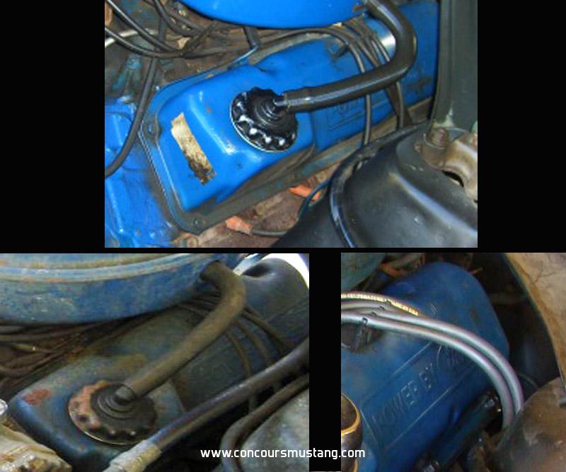

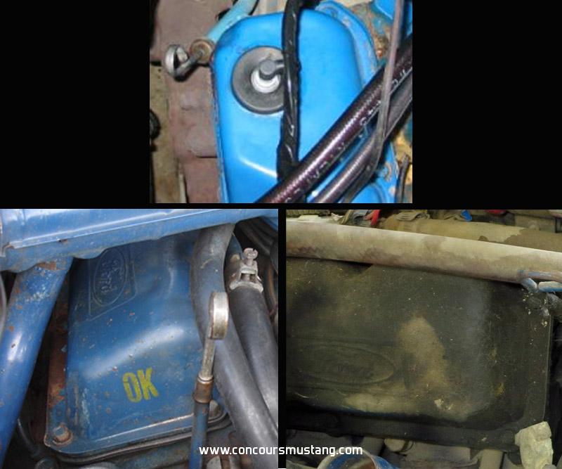

Re: M-Code Valve Covers
« Reply #3 on: July 22, 2023, 08:41:20 PM »
Sorry apparently not a good shot of either side in any of the unrestored later H code and M codes in the Unrestored picture threads so here are a few of each
