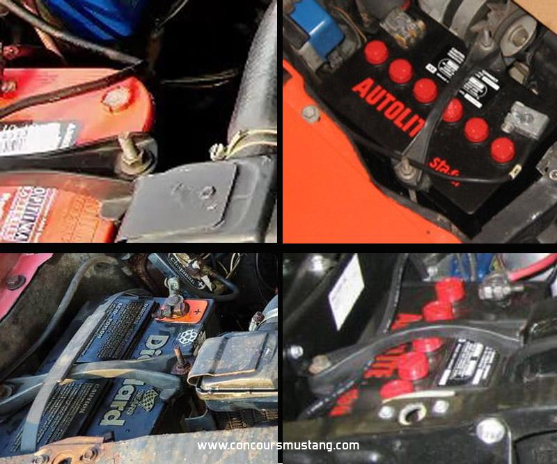

Would, based on unrestored cars built at the same plant as yours, suggest that a metal one would not be original for your car and they were not "using up" old stock. That was likely just transported to the part supply line like so many other parts that were left at the end of production of 69's Some pictures of cars built prior to yours or about the same week
0T103xxx-0R119xxx
