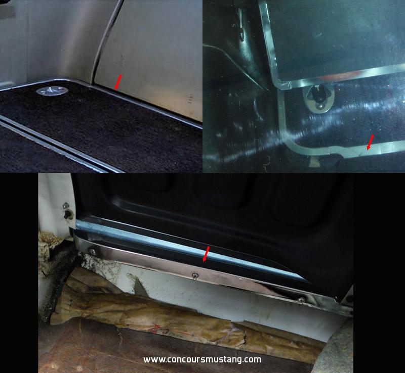

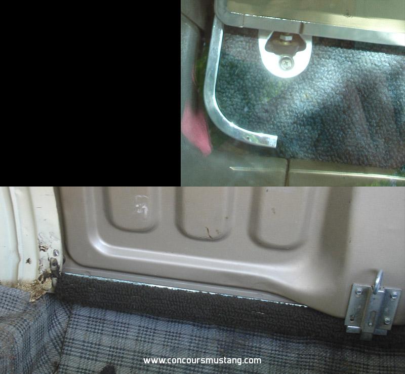

OK a couple of pictures
65-67 fold down rear carpeted floor section rear trim - red arrows
68-70 fold down rear carpeted floor section without rear trim

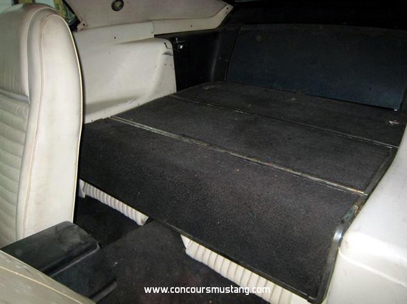

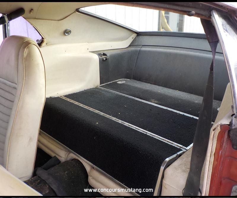

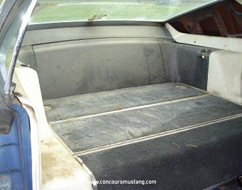

Though its been a long time since a post was made in this thread I just uploaded some additional unrestored pictures of how the rear panels were painted on these three unrestored sportroof/fastback white interior examples
