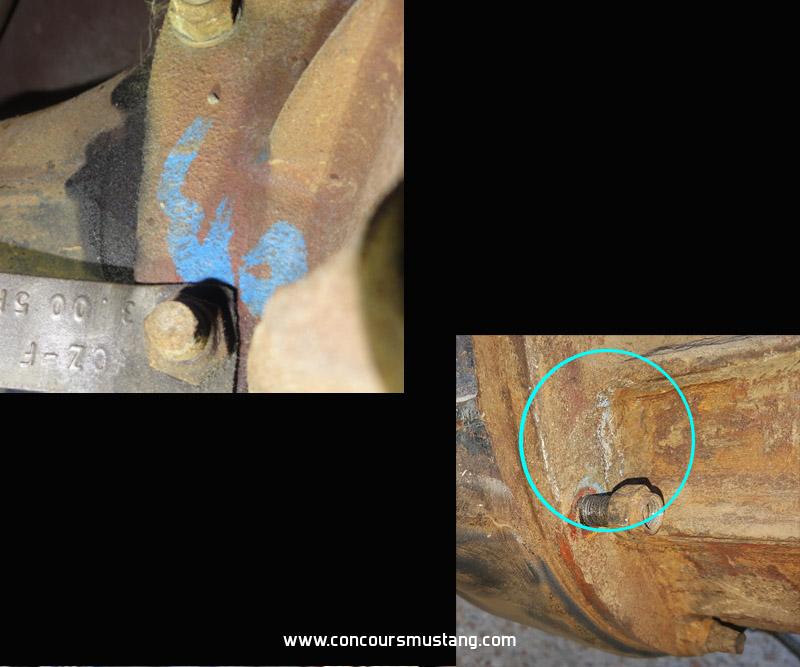

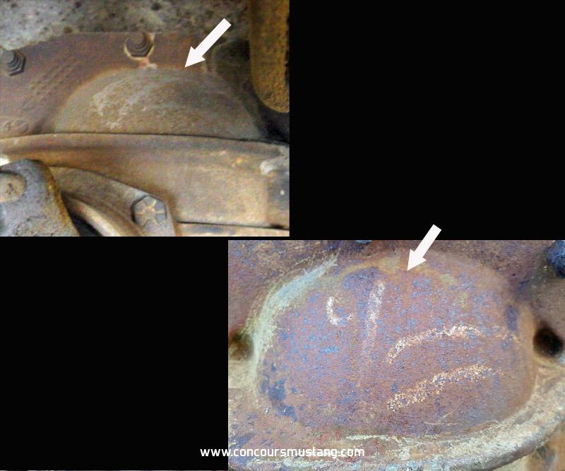

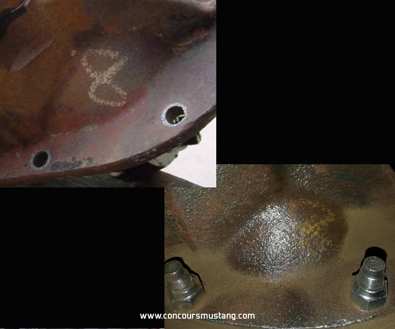

Re: 1966 GT Convertible automatic NJ car driveshaft and rear end markings
« Reply #7 on: August 14, 2023, 08:42:26 PM »
Car VIN is 6T08A248694
76A T 25 12D 16 1 6
Thanks. From unrestored examples (all happen to be NJ also) from earlier in the production year.  Has and shows the expected, usual markings we've seen on others Basically the bottom DS "8" The top and passenger side assembler or inspector numbers. Hope this helps
