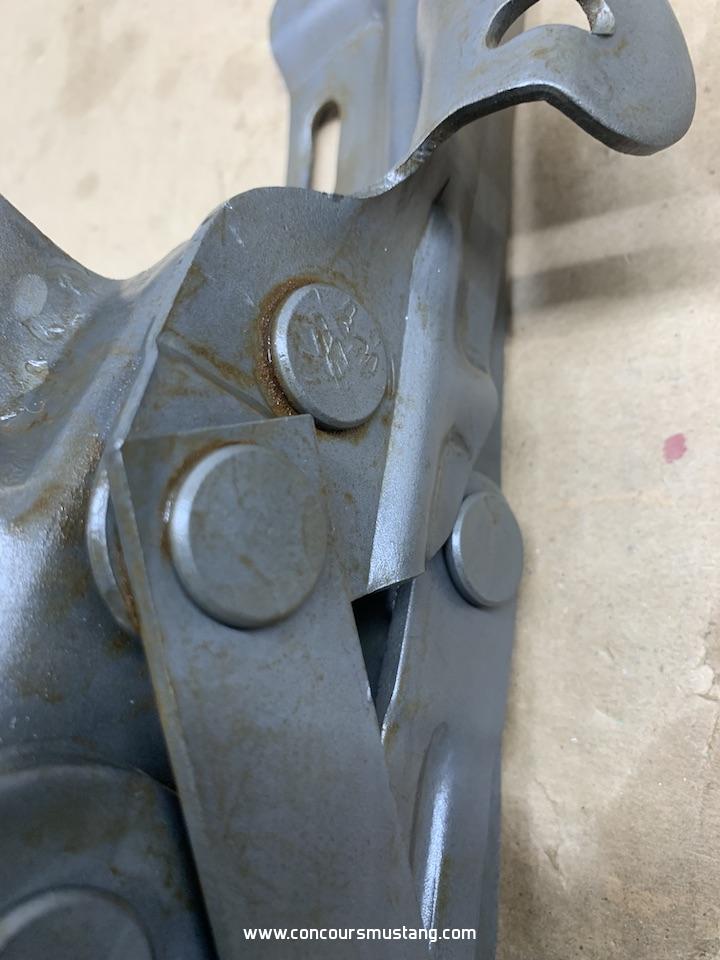

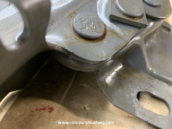

I have now zinc phosphated 2 sets of hood hinges twice and both times I have had the same results. Not sure why, but rusty liquid keeps leaching out of the rivets even months later. I have tried boeshield and WD40 but for some reason I can't get the hinges to stop leaching. I have phosphated hundreds of parts and never has this problem before. FYI I am using Palmetto Hot Phosphating plating solution/process. Parts are bead blasted and and well cleaned before phosphating. I can't seem to get all of the water out of the rivets after the phosphating process. Any help or suggestions would be greatly appreciated. Not sure if stacking in evaporust will help or make it worse

Being that it's oil or grease, apply a solvent (kerosene, acetone, paint thinner, etc) with a spray bottle until there is no more crud coming out. Open and close the hinges several times. If you are not satisfied, try a five gallon bucket with solvent and soak the hinges. DO NOT USE GASOLINE. At one time, I had a five gallon bucket half full of well used Berryman's B12 carb cleaner that worked. And when you remove the hinges from the rinse water after phosphating, spray a lot of WD-40 in the pivot area - repeat.
Note: your hinges need to be a little darker.

Hi Jim FYI That is zinc phosphate. To go darker I would need to use manganese phosphate which would make the springs look almost black. So there is not really any adjustment. How do you suggest I make them a little darker

That is if you want them darker . From the picture the shade looked nominal to me.
