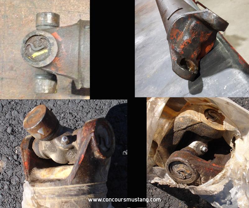

  I found a small amount of orange paint on the rear of my Cobra Jet driveshaft. Pictures were posted on this site of original driveshafts that had large orange markings at the rear. My d/s had no orange at the front but the slip yoke was marked with purple paint.  It is hard to get some of the local judges to get under the car to look.
  • Posts: 24919
Re: Orange paint on the driveshaft
« Reply #6 on: January 08, 2024, 12:48:59 AM »
Just some of the 68 big block orange examples - though we are getting a bit off thread since the question is Boss 302 applications  ;)
Ages and worn there is still orange left on these examples
