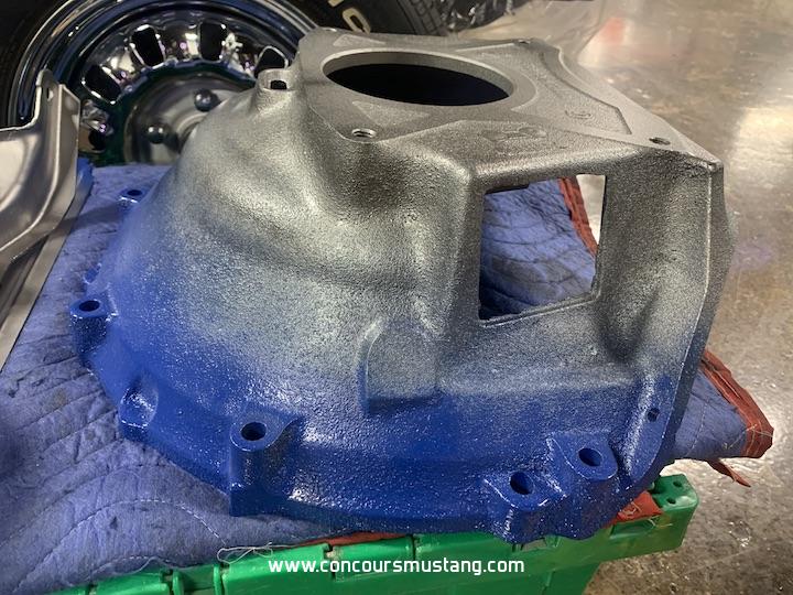

One step forward, ten steps backs seems the be the theme of my build, probably why it is taking ten times longer to build. So I had my painter mix up some paint for me and sprayed it, however the paint refused to cure. Not sure what I did wrong with the hardener, but unfortunately I had no choice but to remove the paint. The good news is that the paint came off with wax & grease remover with no pressure, just a quick wipe. Will give it a light scuff with 400 grit sand paper and re apply, this time using the right product with the right ratio's. This will also give me the opportunity to adjust the color and the gloss as the previous paint I used was off just enough to bother me.

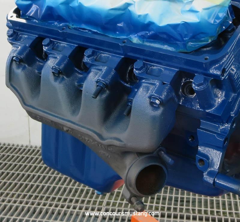

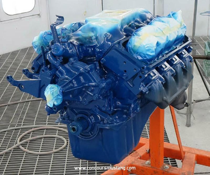

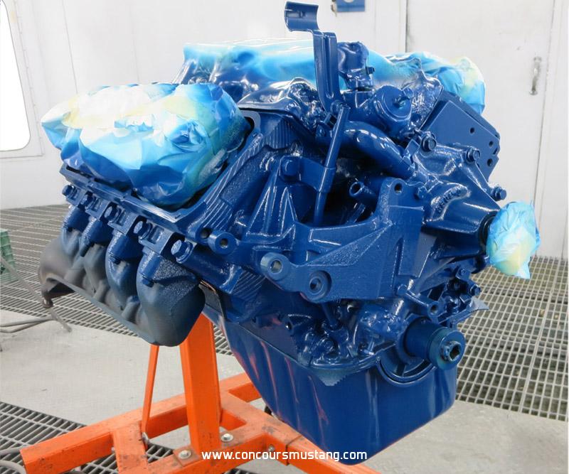

Do you have a photo?
Re: Engine Paint won't cure hardener issue, strip & repaint! 1968 San Jose
« Reply #4 on: August 21, 2023, 04:37:13 PM »
ditzler dar PPG 13358, dxr80 urethane hardener, and dx 265 flatting base @ 25% to 30%
Here's a couple
« Last Edit: August 21, 2023, 04:45:44 PM by J_Speegle »

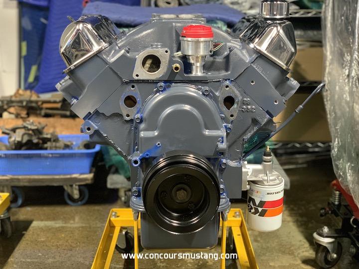

I just saw that pic of your engine on your restoration thread-your San Jose color looks much lighter than my Dearborn FE. The Bill Hirsch is darker than your engine.
Here is a better photo of the paint
