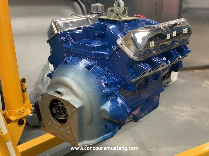

Jeff posted some photos above that are darker than the paint I used on my motor

I just sprayed some of he PPG and it looks much lighter than I expected. Sure seems difficult to get a sample of what it should look like.

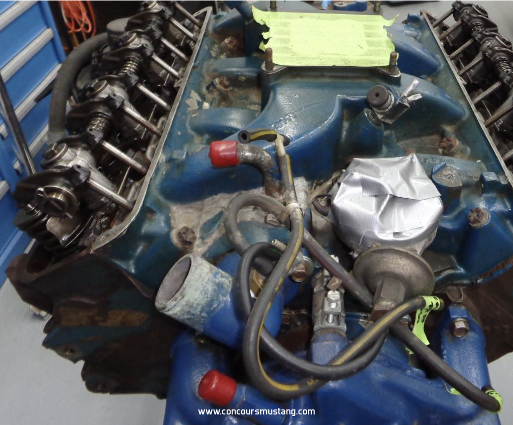

A little late but attached is a pic of a low mile FE (Dearborn build 5/68).
The intake manifold and everything but water pump and thermostat housing are original paint.  The water pump and thermostat housing was painted in 95 or 96 with Bill Hirsch paint (no primer).
Jeff is right though computer screens are tough to compare paint shades.

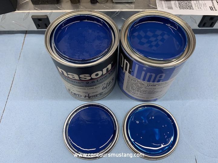

Thanks for the photo. There is definitely a difference in color and shade. The Bill Hirsch paint looks darker and more opaque, than the original paint. It looks like the PPG 13358 is a light/medium blue and also has a translucent quality to it. When I sprayed it, I found that it does take a lot more paint to cover than I am used to applying, due to the translucent characteristics of the paint. I guess the question is which paint looks more like the paint when it was originally applied at the factory. I realize it is very difficult to judge from a photo, but there really is no other way to compare the various finishes. Unfortunately there are so many different versions off the Ford motor paint out there and I have seen so many different tones and shades of blue that I am not even sure what product to use as I have about 5 different paints that are all different. I hope that the paint shop mixed the PPG correctly, as that is about the only way to know for certain as it is based on the original formula. This is what I used, well the last time that is. PPG paint is on the right
