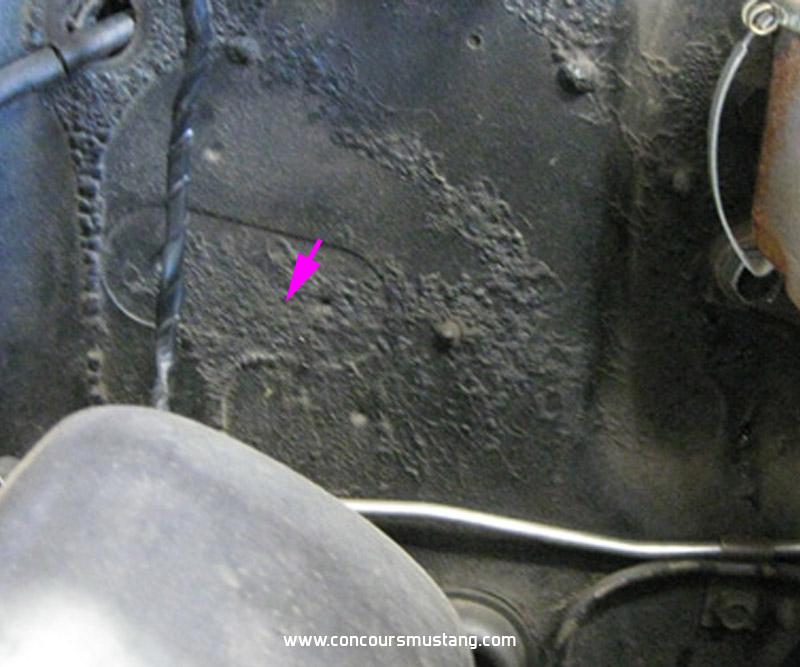

« Reply #6 on: May 07, 2011, 02:08:55 PM »
Here's the holes on a Feb '65 San Jose car:

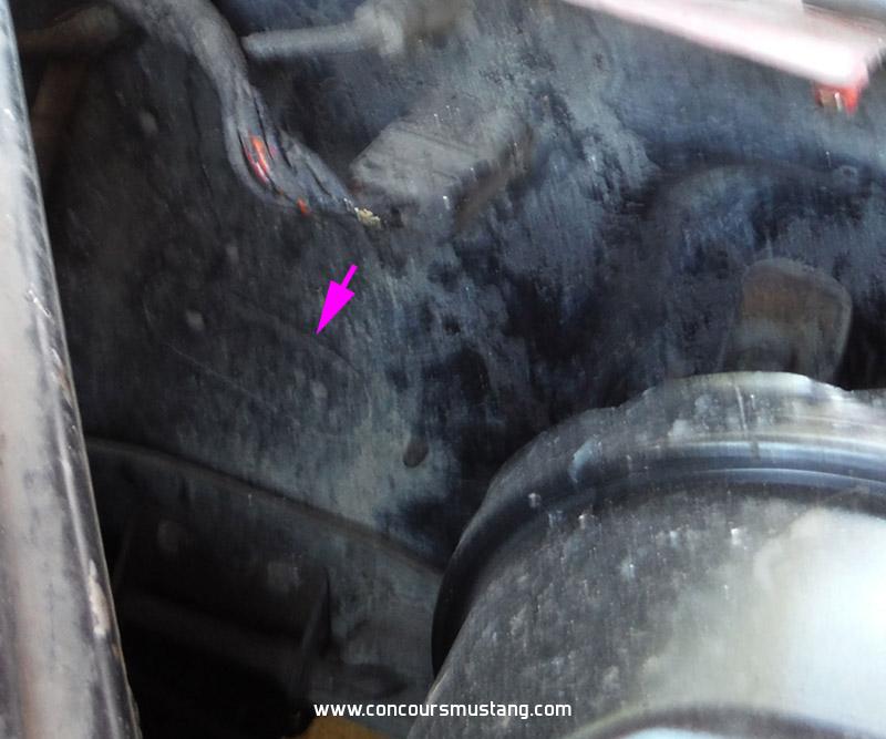

« Reply #7 on: December 20, 2024, 09:59:51 PM »
Since the earlier pictures linked to this thread were stored on outside locations they have since failed for one reason or another plus some were not from the production period and showed versions that did not apply to the OP's request I'm going to post some additional pictures to help out others who may be looking for the same information.
To confirm that the cars are from the same plant and about the same production period I'm posting shortened versions of the VINs
5R2055xx
5R2064xx
5R2141xx
Earlier production (will try and include those findings in the 65 San Jose Running Changes Thread) had different firewalls and in turn different features and AC line configuration.
