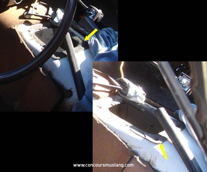

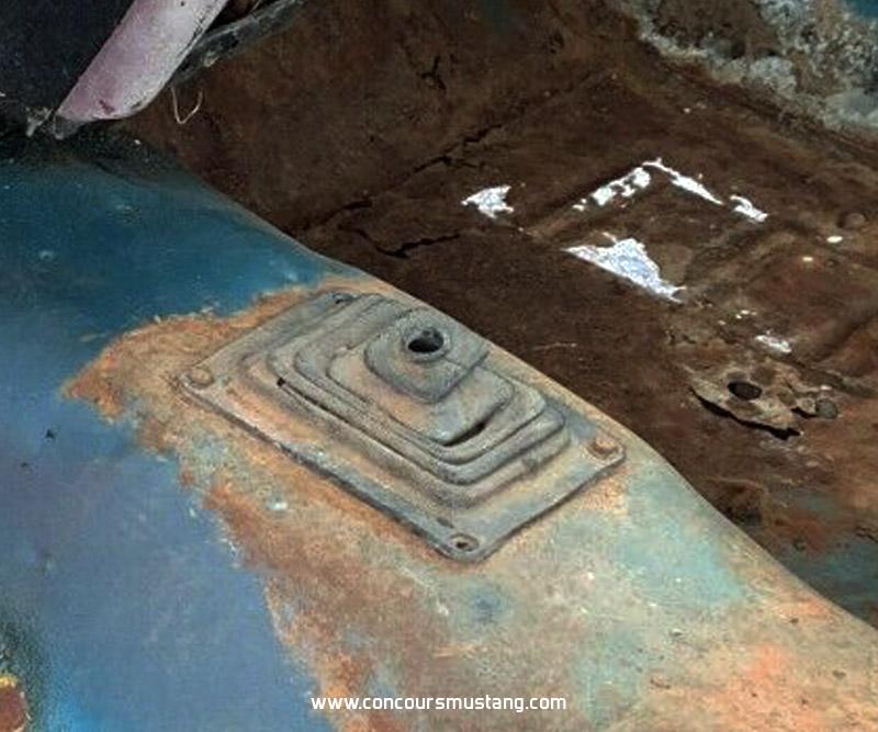

Between the boot and the floor there would be the lower boot and a rubber basket around the hole. All are compressed between the upper boot and the floor once secured.
Shifter gasket or at least what is left of an original
69 lower 4 speed shifter boot

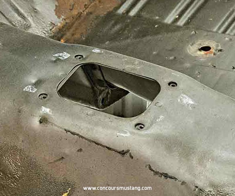

The boot is attached with four bolts to the nuts welded in the support plate welded to the forward floor section as shown below . Couple of the bolts are missing/removed but you get the idea. The design of the boot and its "folds" (for lack of a better term) holds the bezel in place.
