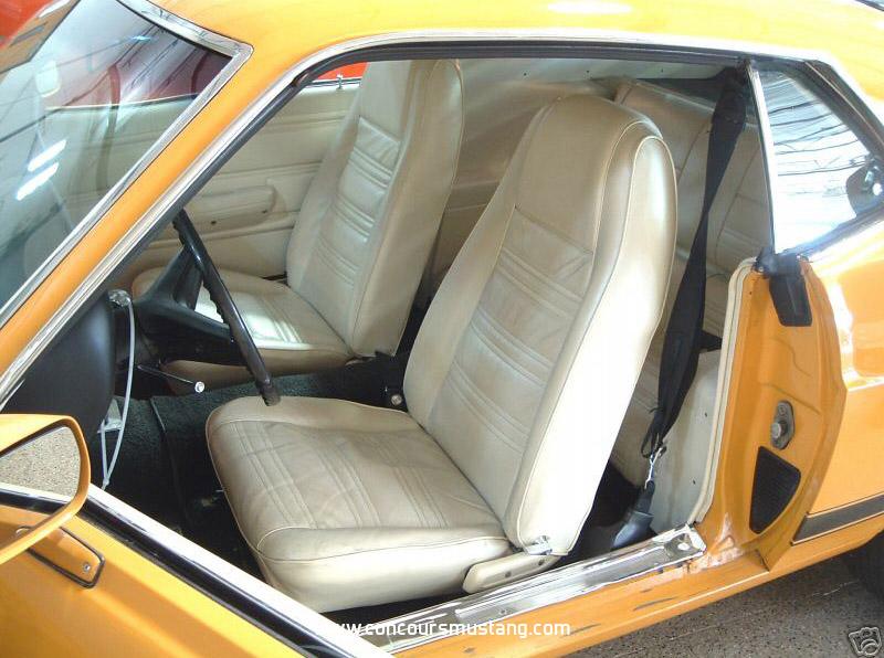

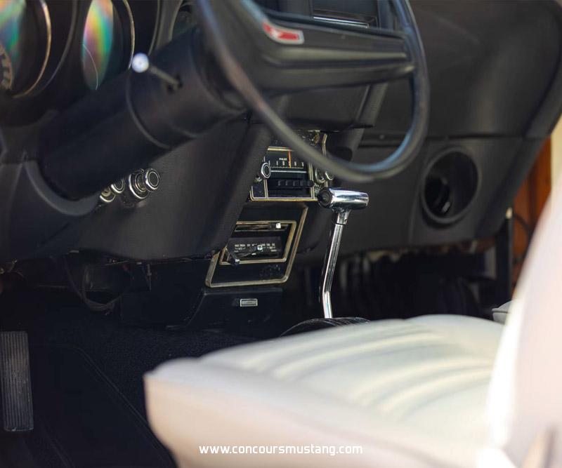

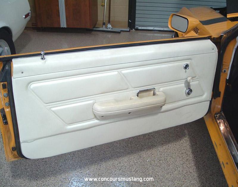

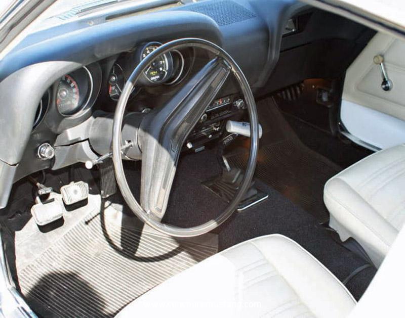

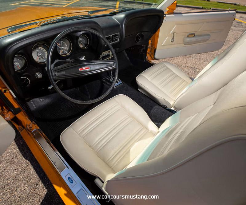

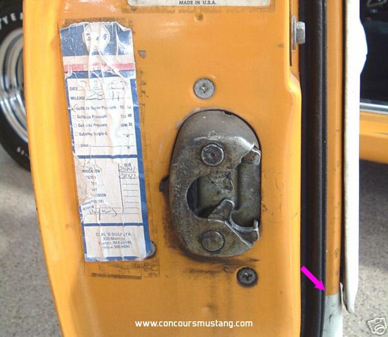

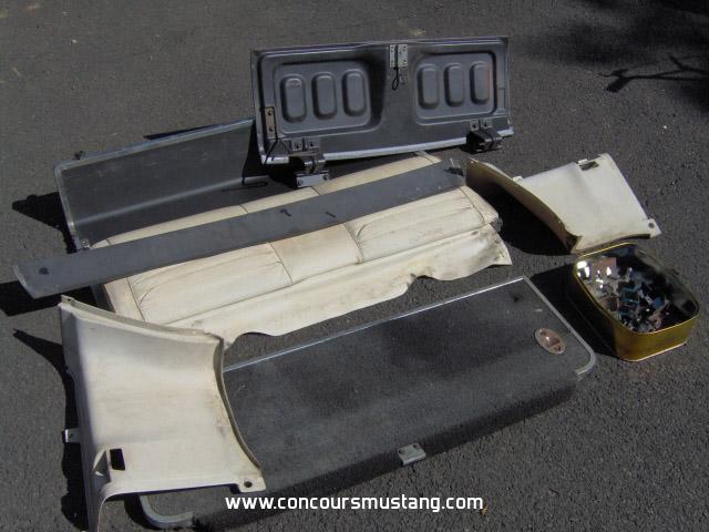

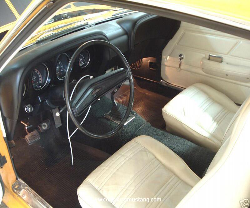

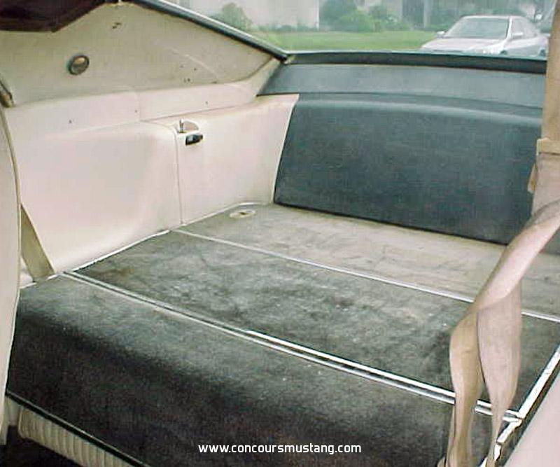

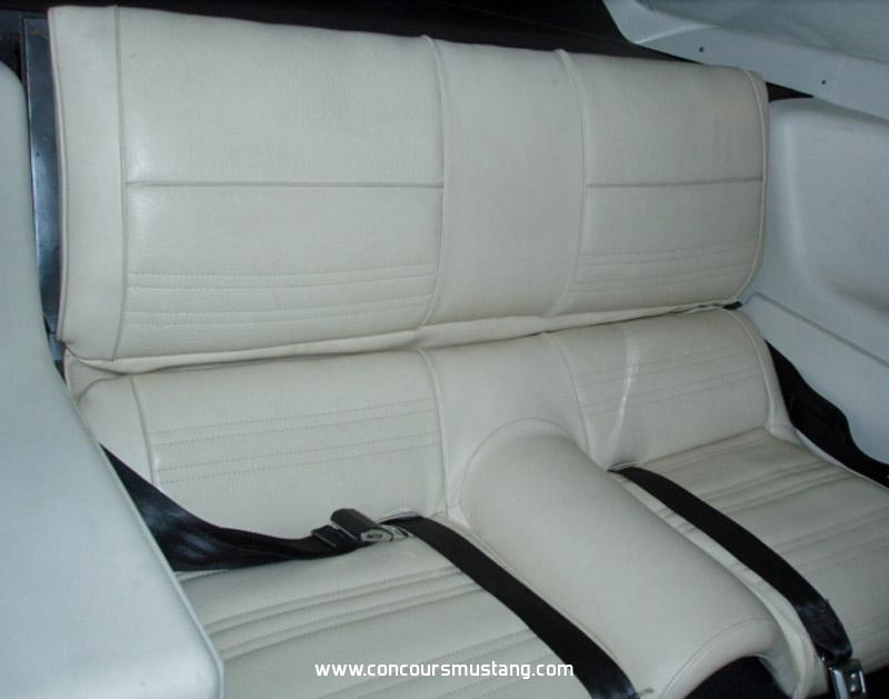

Here are a bunch of pictures. Hope this helps you and others
Did include some non-fold down examples since they included other details and finishes useful in doing your car
Close up of how the back edge of the painted surface was treated on this particular Dearborn built car. Does match other 70 examples I have
Dearborn example from just before your cars completion date

now to another question the pics provided in these emails as the 1/4 fiberglass panel ( the one that LOCKS THE FOLD DOWN) 1 PIC shows it BLACK AND 1 PIC shows it white;
which color should it be?  Im thinking white
Re: 70 Boss 302 w/ white interior questions
« Reply #10 on: October 10, 2023, 07:59:22 PM »
Last two pictures in Reply #5 shows that the rear corner panels with the whole for the fold down seat lock are white

I dont come around here much but...
On my untouched 70 Boss with white Standard interior built on 03/16/1970 the side panels that hold up the fold down seat are black.
You can see a pic in the link J Speegle originally linked in post #2 above. (it's the last picture on that thread-- to help you ID the pic, the trunk is open, which you can see through the rear window.)
FYI-- my Boss is a 2 owner car & I am the 2nd owner.  I am friends with the first owner who ordered it while on tour in Vietnam.  Point being, this car has a known history & changes.
The answer is... it depends on your car.
If you dont know then you can choose white or black, because both are correct on a white std interior car.
(although with ZERO research to back this up...I suspect white would be the more common color)
« Reply #13 on: September 04, 2024, 06:44:41 PM »
Good choice. As mentioned, I think, have only found the pieces finished as shown below except (can be expected) on some "restored" cars or someone copying a 69  ::)
