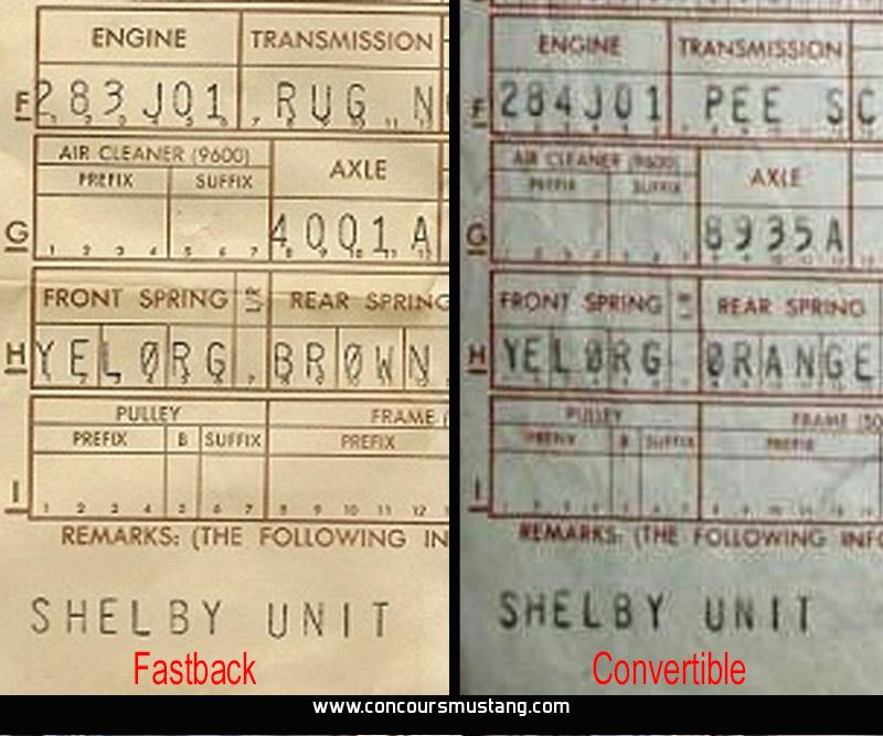

For the rear springs we would need to know your body type since the factory build sheets show Brown while the convertible shows Orange. Guess the Brown could be mistaken as orange in some of the examples of original markings on 68 rear springs I have.

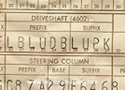

As for driveline the colors are below taken from a 68 GT350 4 speed. In this case the body style does not make a difference nor does the transmission type or when, during the production year, either
I think it shows the abbreviations for the coding in the article in the Library titled Paint Marks the Basics or something like that. Works out to be
Light Blue - Dark Blue - Pink
Light Blue - Light Blue - Pink
Hmmm looks like Light Blue Dark Blue Pink to me.
Lost focus for a moment - Fixed  :)
