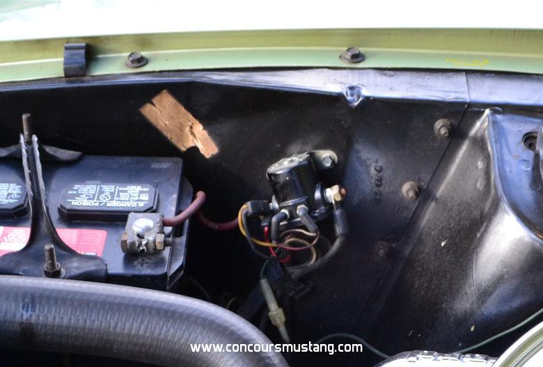

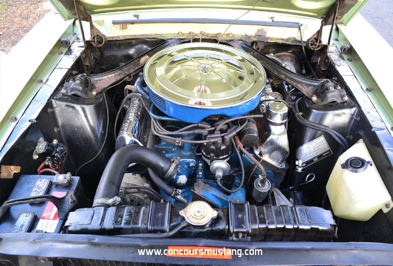

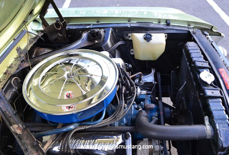

I brought some images of the trunk & hood light option taken from Jeff's recent post of a late build NJ 67 Unrestored, low mileage GT. They may "shed some light" ;)  onto a few more details...
A great look at the clips typically found on the RH strut brace

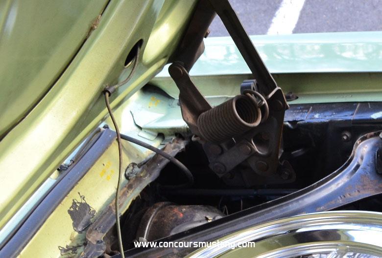

NOTE: Being a "LATE BUILD", you may notice, the bottom of the hood has NO GROMMET (nor at the top but not in images) and the rolled edges in the hole(s) where the wire penetrates the hood inner structure. Discussed in other threads, this "rolled edge" is a feature found on all 68 hoods and the later 67 hoods. (Very early 67 hoods actually had NO HOLE and any turn signal lamp or underhood lamp wiring did not penetrate the hood but was instead affixed to the hood reinforcement structure with similar (same) clips as the mid-year hood uses across the upper reinforcement surrounding the turn signal lamp area (see pictures earlier in this thread of these clips)
Also, another example of the (metal?) clips used to secure the wiring to the right hand shock tower brace.

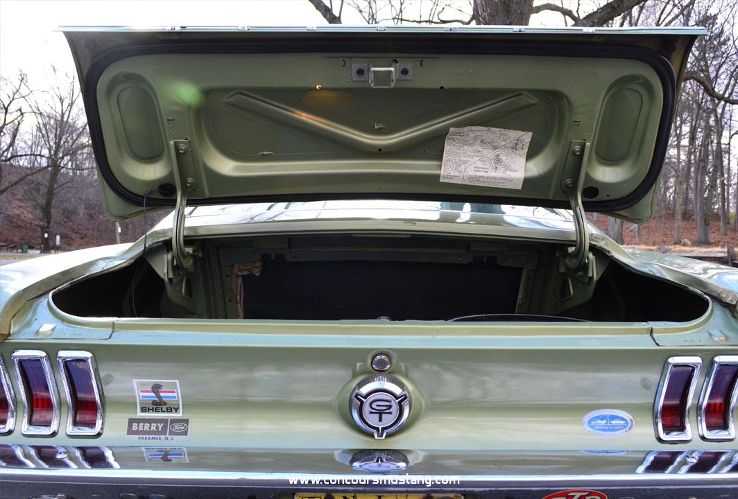

Re: Re: '67 Trunk courtesy lights
« Reply #27 on: April 04, 2018, 06:19:12 PM »
And then there is the trunk
« Last Edit: October 22, 2023, 11:52:24 PM by J_Speegle »
  • Posts: 5101
« Reply #28 on: April 05, 2018, 12:19:44 PM »
Closest reproduction I found in a short time looking is AMK. Looking at page 144 of the AMK catalog (bottom left), item B-10723 gets you a pair for $4
So, is it typical to find 2 or typical to have 3 on an original car?
*typo correction 9/8/22
« Last Edit: September 08, 2022, 08:51:08 AM by 67gtasanjose »
« Reply #29 on: April 05, 2018, 05:56:04 PM »
Richard, that looks like a good match.  The number 372303 I found used on the 65 Mustang in the exact same place, qty 2, on the attached drawing.  I found it used in four different wiring related applications in the 60-68 MPC, with only the same 65 Mustang reference, the others were other vehicle types.
The 65 drawing has the -S suffix, but the same application in the 68 MPC was the -100.  I found the -S as part of a back up lamp kit for a 63 Falcon.
Based on what I've seen for this application, I would get the -S.  As for quantity, the car that I stripped only had one, but that is obviously not enough.  The 65 drawing shows 2, the low mile NJ car had 3.   Certainly we should be able to get 1 or more offerings on this.
