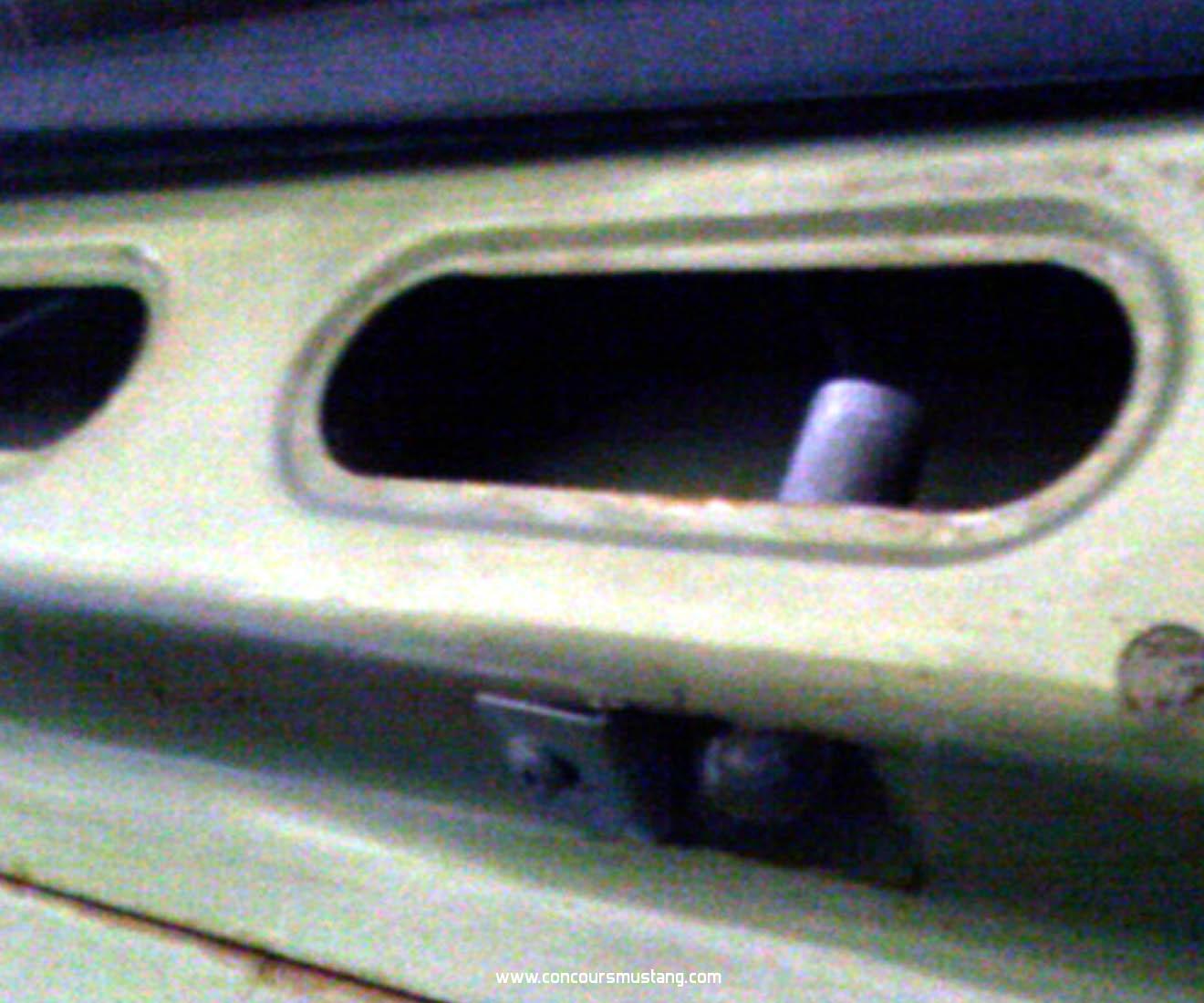

A few more pics of the trunk light

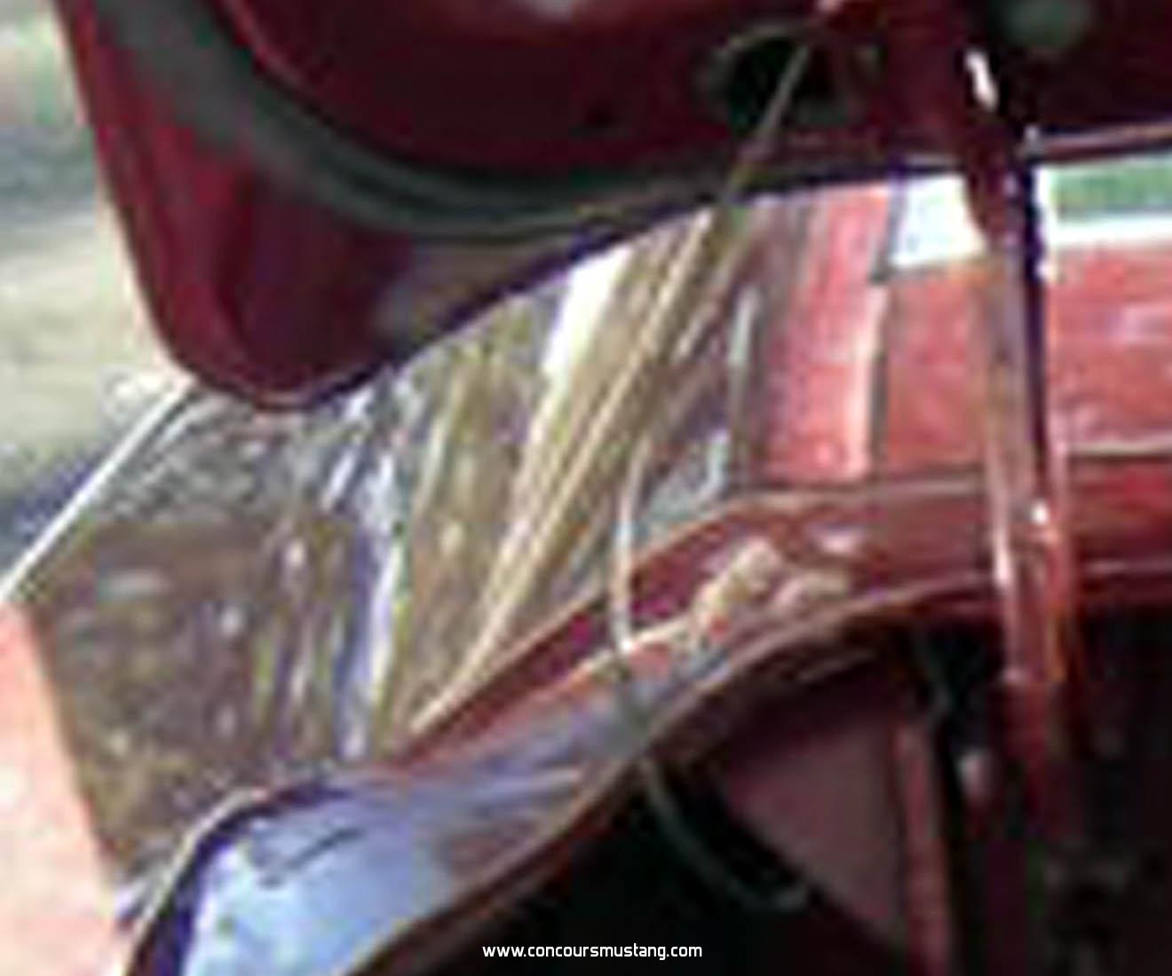

The one I have from an early Dearborn car is a long single conductor wire from the door jamb area.  Black wire not sure if there is a stripe.  Has a woven protector on the wire. Ran under drivers side door sill plate and over wheel well.  A bullet connector to the single wire mounted to the deck lid. Connection in the air below the trunk gutter drivers side.  Hope this makes sense.

Correct.  The ones I've seen can over the wheel well with the tail light harness.  The trunk wire had a narrow cloth tape band to attach it to the tail light harness, then split off to go up to the decklid.

My 67 did not originally have the trunk light Option. However, as mentioned above, the wire with a female bullet connector runs over the wheel well, next to the taillight harness. I have attached a picture for your info.

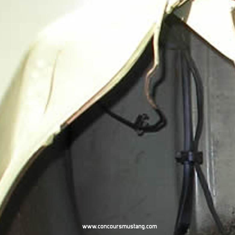

Some of these have been posted in an earlier thread
All San Jose examples
Ignore the body color on the wire - repainted car
Wire retainer

If your vehicle didn't come with the courtesy lamp group, you don't have the wire. I sent my original hood lamp and trunk courtesy lamp feed wire that runs to the trunk to Alloy Metal Products, that's why they are now available. He needed original examples, and they are relatively scarce.
The original trunk lamp courtesy feed wire is not part of the tail lamp harness, but an individual lead that is cloth taped about every 16" to the tail lamp harness.

In the first picture, I have highlighted in red the separate, but parallel, wire for the trunk light.  It is literally a single wire, with protective sleeve, that runs the distance.
