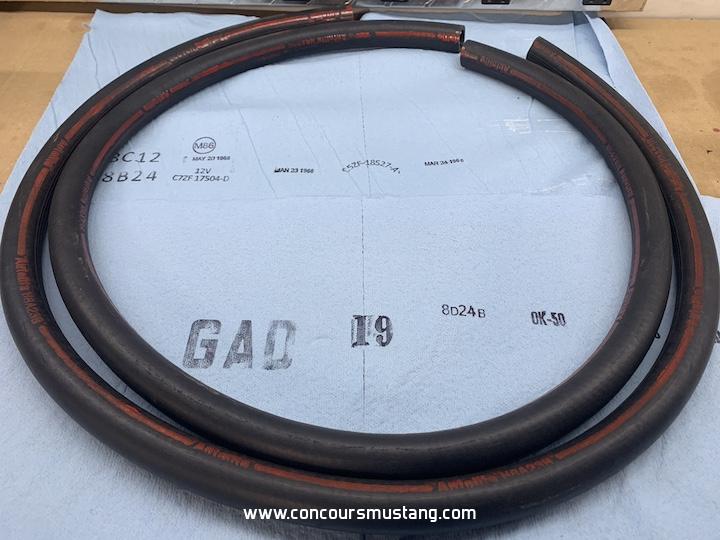

This I at least one factory variety . Original hose that Ken Bramblet used as a template when he used to make the hoses up for different vendors. He stopped doing it about 15 or 20 years ago. He passed his original on to me that I still have a memento.

Thanks Bob it does look pretty close to the Marti hose, don't you think? Was the template a stamp or a stencil?

The original hose in the pictures appears to have been stamped. I think Ken when he made them up years ago using a ribbed hose that used to be able to get from Ford used a stencil and paint .

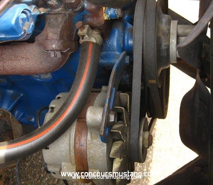

To the question. Here is what I think we have as evidence at this point
Your car
8R02S162374 Built June 5, 1968
Examples posted
Solid - 8R01C1673xx Built June 16, 1968
Solid - 8F01T20531x Scheduled build date June 11 0r 12, 1968

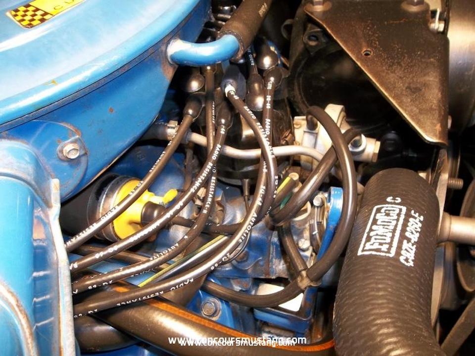

Some additional shots of that fine example. Notice that the hoses have not been replaced and the factory sealant is still on the hoes at the firewall in the upper picture
We do have other examples with the stripe and intergrated AUTOLITE and number but that was not the question  :)
So trusting both of these examples (seen them both in person) IMHO the hoses were in the system around the same time as your car was built so I would say its possible though I would love to see more original examples. Bu then again I would like to see more of either original examples since both are difficult to find. Now that I think about it I didn't check any of the 68 Shelby examples. Maybe they will provide some additional data points to the discussion and possibly more solids.

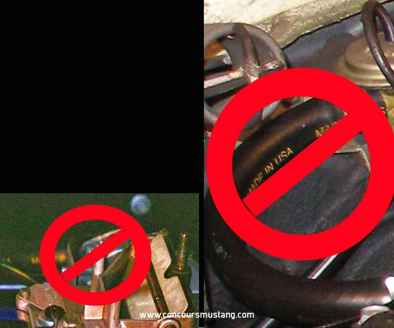

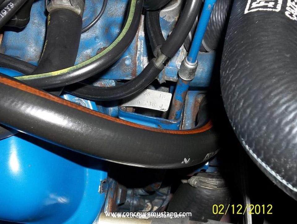

On the same related subject here is another angle of the solid red stripe heater hose. There is identification marking on striped hose. The other hose (that connects the the intake nipple and the heater control shut off) has a MADE IN marking in white (owner often used an older light with a yellow cast to it) and no visible stripped hose. This is 8R01C1673xx the very nice unrestored owned originally by one of our members who in recent years sold the car to another member that we often use to illustrate practices and details of late 68 San Jose production as well as for other purposes.
SO would love to see if we could find a possible third version but unfortunately a non-striped hose will even more difficult to identify but no one said or should say much of this is easy.  ::)
NOTE: Was reminded in another thread that this hose is suppose to be a preformed hose which suggest or supports that this hose and its markings is not original to the car. Sorry I missed that detail and had forgotten that details when posting

Thanks Jeff those are some very interesting photos. It looks like the "Made in USA" stamp is yellow and you can just make out the solid red stripe. Looks like the hose in on an air conditioning car. Not sure if that makes a difference. FYI my car does no0t have AC.

Thanks Jeff those are also great photos. Looks like the hose is strapped to the fender brace and also it looks like a clip that the hose passes through on the shock tower on the hose to the water pump. You can also see the intake return heater hose in the background with the red stripe. Unfortunately the reproduction hoses are not available in solid red as far as I know, which is not a problem as I will stripe my own. Also the quality of the reproduction hoses I have seen is not that good. If the stamp on the made in USA hose is any indication of the stamp quality of the originals, it indicates that the repops are very poorly stamped compared to the nice crisp quality of the originals.
Also I noticed that the vacuum hose has a red and white stripe on it compared to the green and white reproduction vacuum hoses I have seen. This is the first photo of a red & white vacuum hose that I have seen. So to go down the rabbit hole even deeper regarding hose stripes, were some vacuum hoses red & white or any other colours for that matter?
