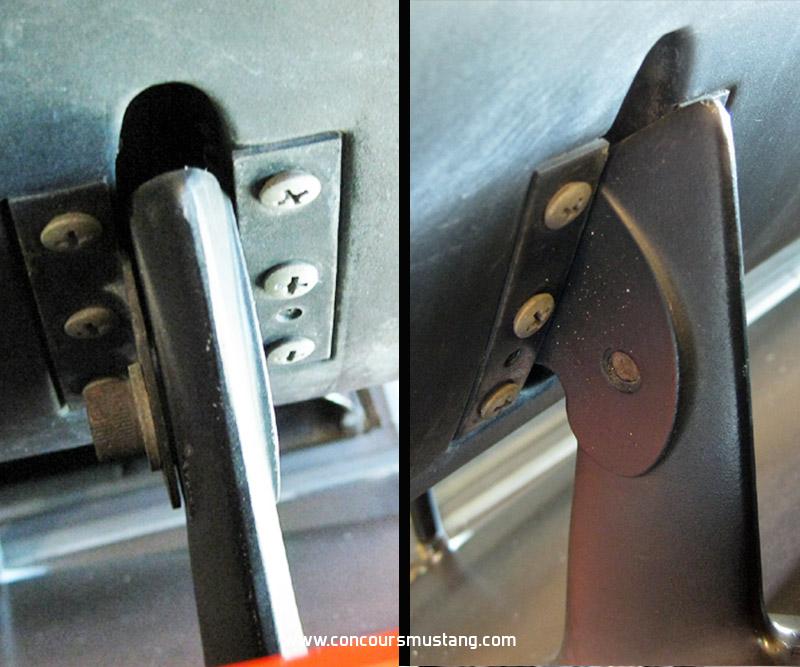

Original 70? Rear Spoilers, are the AMK hardware finishes correct for installation? They list the Allen Head Bolts as Black Zinc Shiny, same for the twelve Phillips head screws, and two washers, other two washers say Plain finish

There is a picture (first one) in the thread below that shows the finish of the plate screws on an original presented by a member. Not the focus of the thread but at least what I would consider a clue for those items. Looks to be a cad or zinc plating on those. As a note its not unusual to find a spoiler that has been rattle canned black, completely, to "freshen up" the look by a past owner
https://www.concoursmustang.com/forum/index.php?topic=6964.msg46020#msg46020
And here is a close up of the hardware on an unrestored 70 for you to compare the descriptions in the kit to

NPD have good reproduction
